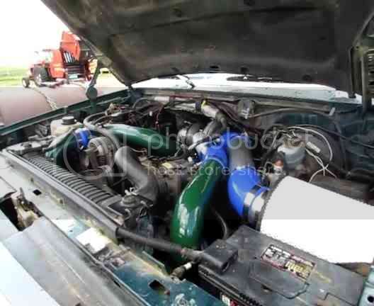

Here is look under the hood and start up... I still need to get some of the wires and hoses a little more neat...
This is a video....
