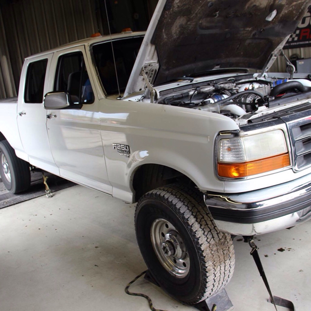

What size tire is in that pic?
Do you have an RSK? if so, what size?
Sent from my SM-G920V using Tapatalk
They are 305 70 16's. No RSK for me as I have found it hinders the launch at the track. Thats with F350 springs and I custom made searches to work with the 79 D60 thats in it.

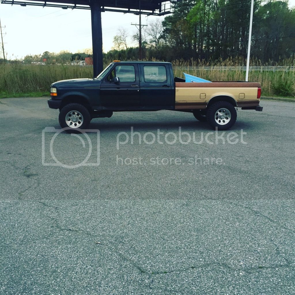

I'm gearing up to do the same swap on my truck, and I have a few threads saved for the axle swap, but do you have any tips?
Good drill bits and a welder lol it's not horrible and I moved my axle forward about an inch as well so the tire was not so close to the fenders.
Figure out what you are gonna do for a track bar and stuff ahead of time
Mudstomper99
Mar 20, 2015
219
I used my stock pitman arm and welded my obs tie rod end to the superduty one and then I used the superduty track bar in a drop pitman arm Laying around from a lift kit they are parallel with each other no bump steer and drive straight down the road at 70

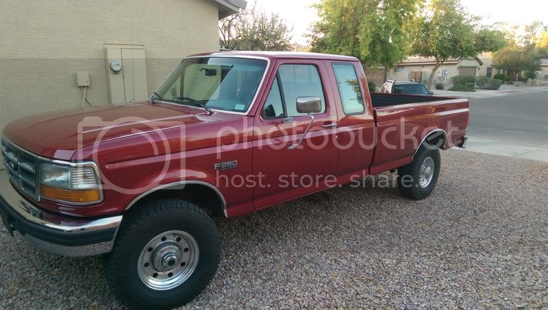

I am new to the forum and just bought this 97 7.3. I use it for pulling the toy hauler and drive it to work once a week, otherwise it sits in the garage with 136k miles on it.
