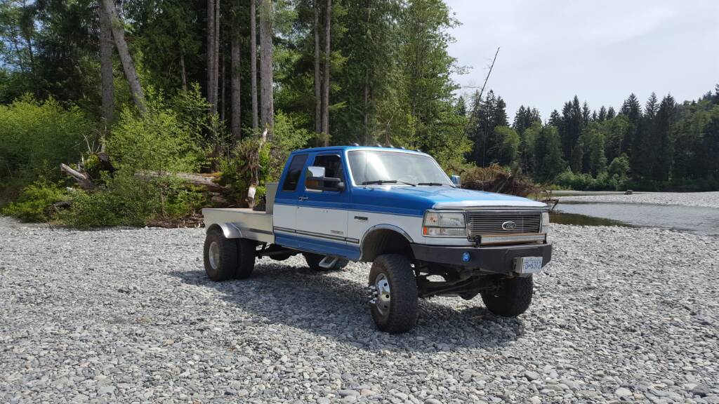

97 with 95k miles getting 4r100, an 05 axle swap and 4wd conversion.

Man I wish mine were that clean!is it staying drw?
Yes it already has the rear axle, trans and t case in. This being done at a buddies shop, he is having to wait on the guy to bring him the radius arm brackets and spring buckets... It has a skirted flatbed that goes on it. Best I recall it will be for sale when finished. But it won't be cheap.

Yup and the traction bars lol. Thinking about going with a wheel and tire setup similar to this.
