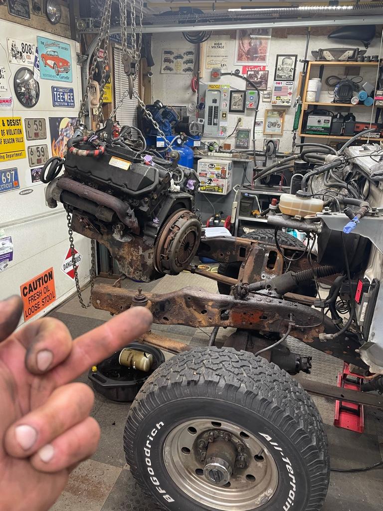

Since I have the engine out and the oil pan off
Should I replace the rear main seal?
Just because I’m in there? Don’t see any leaking but it is 26 years old

Well I just looked at mine and it’s dry as a bone so ima replace the oil pan and get on with life
Nothing personal with the finger
That goes out to the world in general

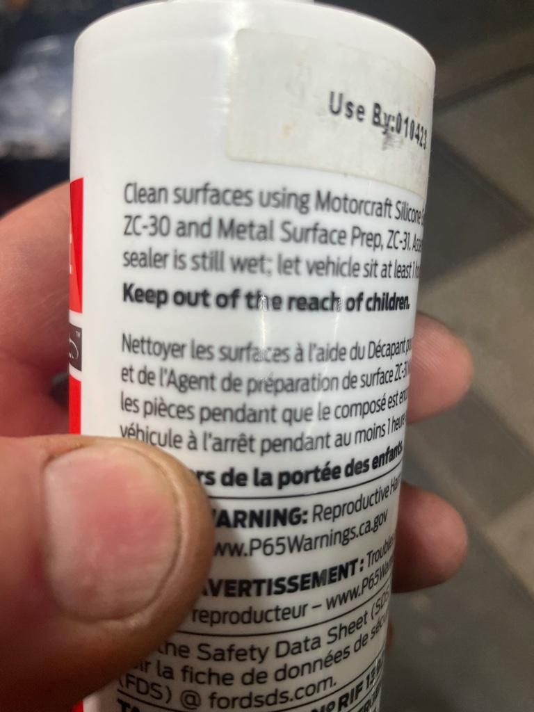

this is a brand new Ford pan, I assume you apply the silicone over the painted surface? where it seals up against the block..
and, whats the best silicone remover? Ford recommends their ZC-30 remover
and ZC-31 metal prep.
can't find it online.... haven't checked the dealer yet
