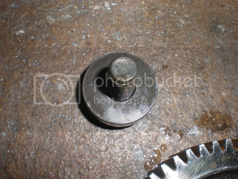

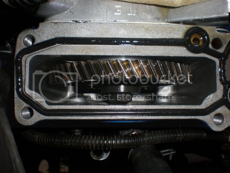

right on all points.
Swapping in my original. The one I have in now is brand new modded Hpop from TE.
Dont think thats it tho. Like you mentioned it was running before.
oh and there is no pulley slip

It is wired the same way when I started it last. The way my loom is positioned the right plugs meet up with the right sensor. Thats the thing, last time I had it running. Albeit with low oil pressure. Nothing has changed except a new melling and galley plugs where they are suppose to be. I have put my stock hpop in just waiting for these $300 batteries to charge. They can handle about seven extended cranks and then they are shot (optima red).
