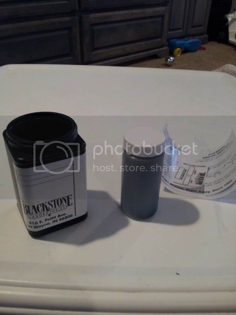

Here bish...
Good man. Tell Reid I like his choice in toys
