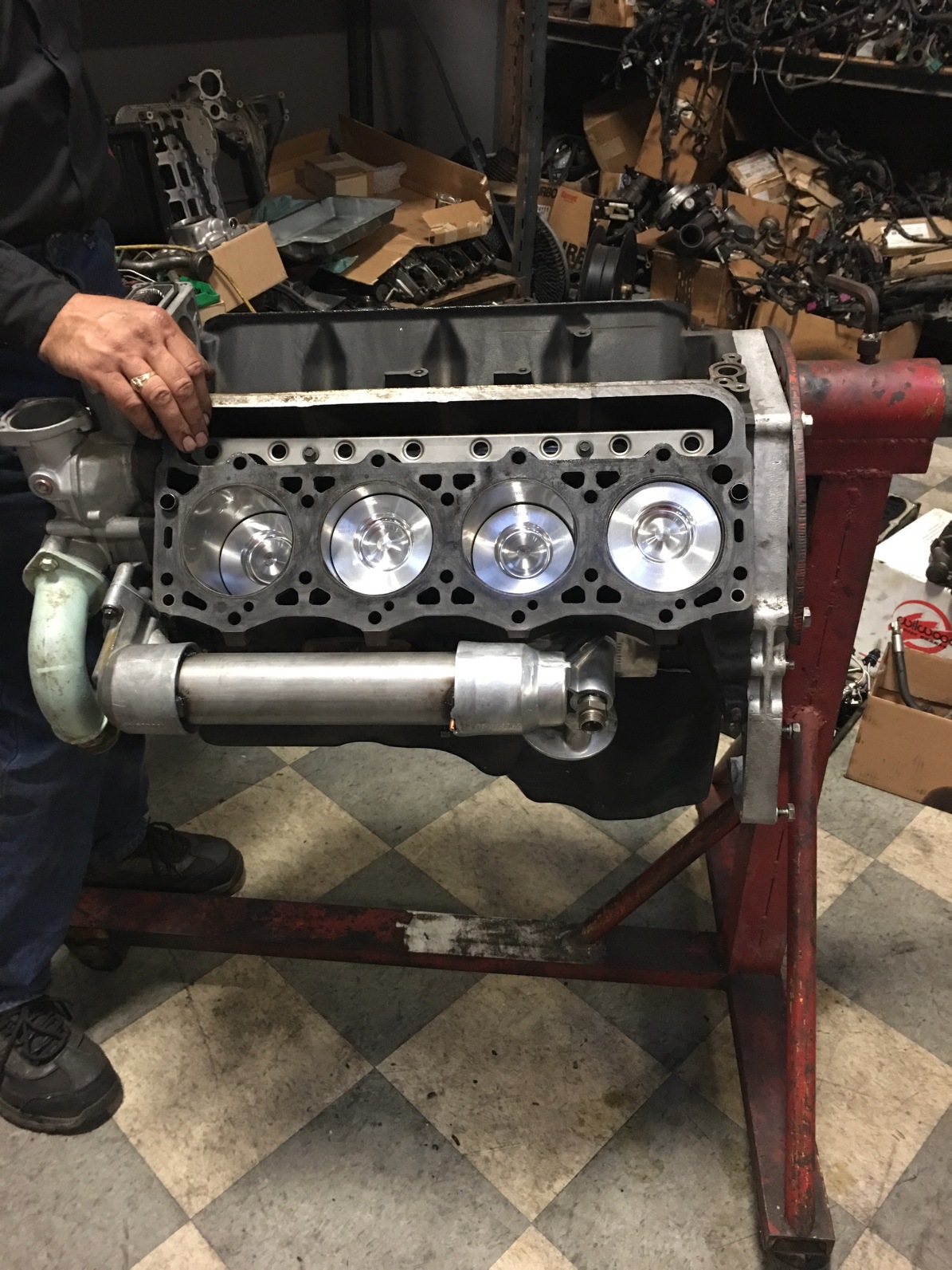

Then at about 5pm he sent me this picture:
Lol, you can see the adapter plate on their engine stand is totally warping from the weight of the motor on it.
