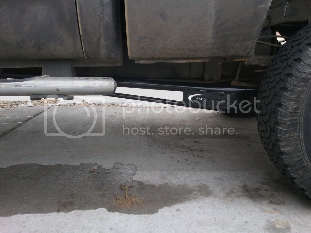

Excuse the dirty truck but here's the traction bars installed.
I feel like it launchs a little better but I just want around block with them.
