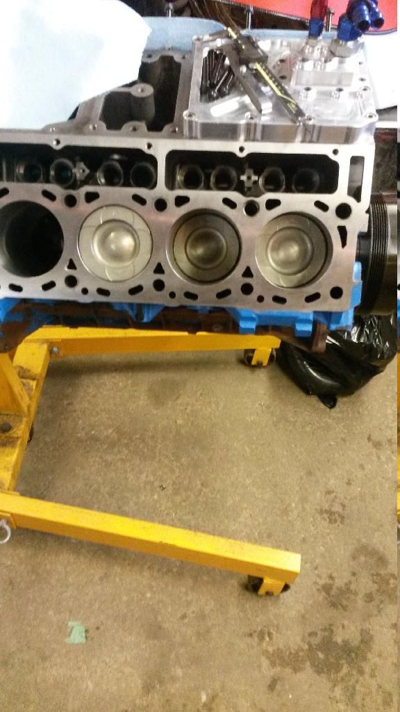

Problem is that with higher lift and more duration, you inherently have less valve to piston clearance. Throw in milled heads, milled block or both its even closer.
Go to the strip, sled pull or do a burnout and break a u-joint, input shaft or something else you end up with an over rev.
Even with better springs and pushrods I have still seen these hit. Mainly on the exhaust valves.
Valve reliefs are good insurance and do not make any bit of difference on anything else. The pistons I have even in full competition trim; standard bore, valve reliefs and straight wall bowl still is 17:1. And for really most climates is totally fine on a common-rail engine.
My question to most is, if you are doing pistons why not add valve reliefs? Unless its a bone stock rebuild with no future plans of ever doing anything performance to it.

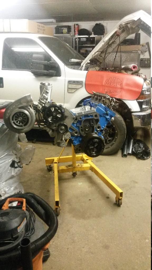

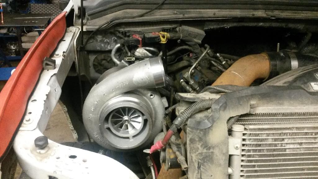

Well it started a few months back. Finally got the big turbo mounted in place. Once that was settled I sold the max powers. Here it is mocked up
http://i870.photobucket.com/albums/ab270/ridin450tolive/F350 Build/20131211_231711.jpg
Then I finally fitted the Midwest forged pistons into the block, here's a pic of them installed.
http://i870.photobucket.com/albums/ab270/ridin450tolive/F350 Build/20140123_155339.jpg

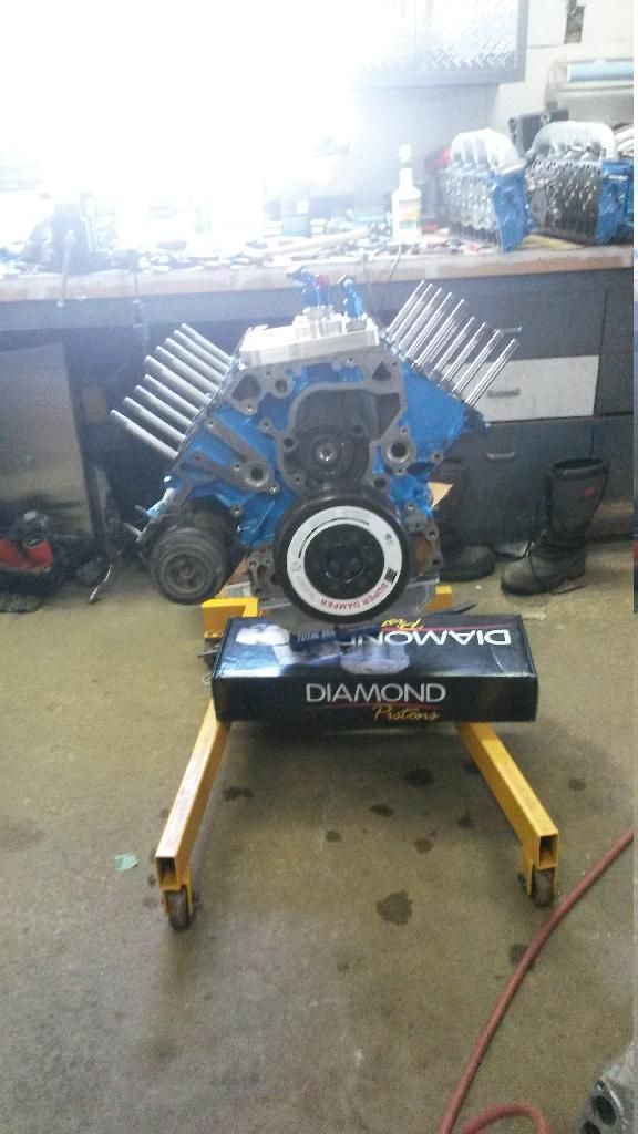

Put the studs in and put the heads on.
http://i870.photobucket.com/albums/ab270/ridin450tolive/F350 Build/20140128_124432.jpg
Here's where it sits now.
http://i870.photobucket.com/albums/ab270/ridin450tolive/F350 Build/20140123_231906.jpg

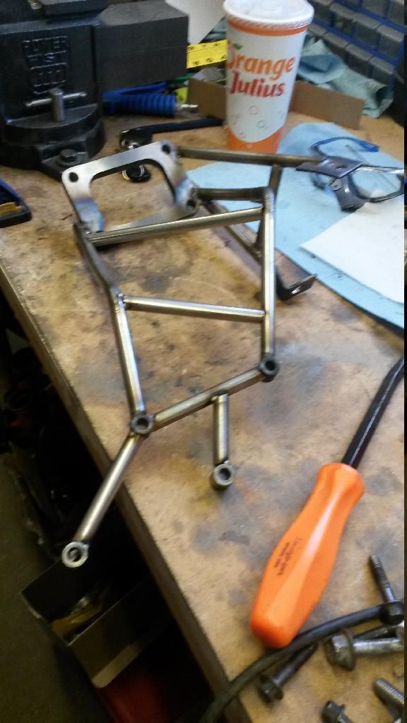

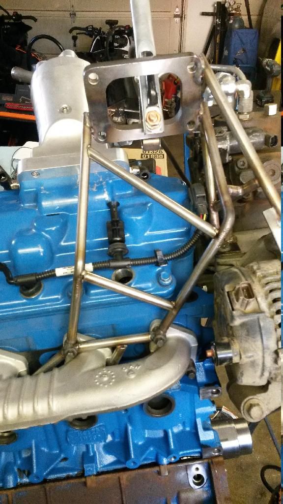

Couple pics of the turbo mount, it still needs a couple gussets but it's solid, I can stand on it. Yes the valve cover, glo plug harness, and such can come off without removing the bracket. Oil fill neck will be moves back 2" for extra clearance.
http://i870.photobucket.com/albums/ab270/ridin450tolive/F350 Build/20140127_095921.jpg
http://i870.photobucket.com/albums/ab270/ridin450tolive/F350 Build/20140127_094340.jpg
