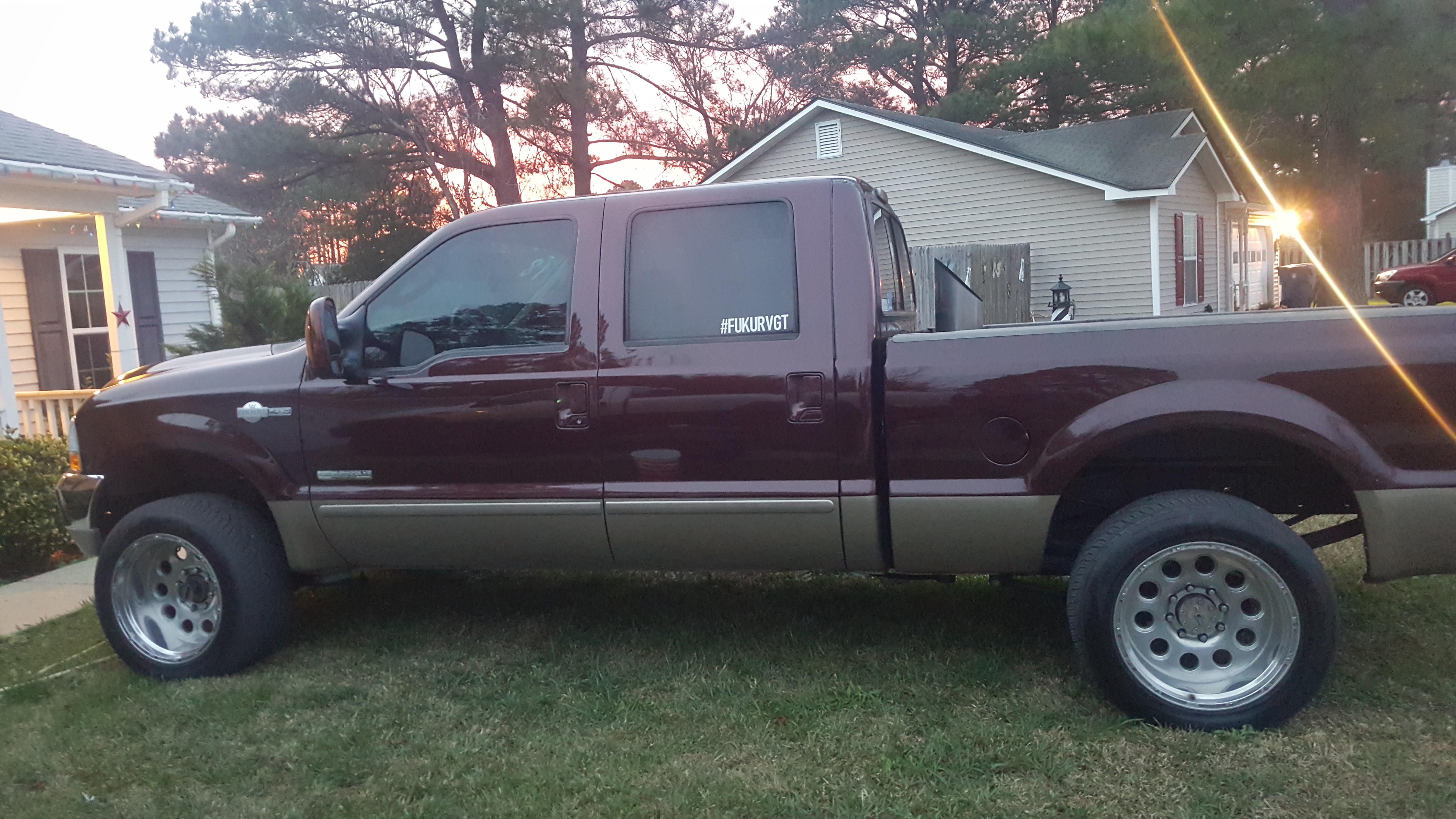

This truck is a tank. A few weeks ago my cold side pipe blew off and ripped my fuel line. Of course the fuel line finds its way into the intake manifold. Truck ran away to 4800rpm then died and hydrolocked, pulled the glow plugs and it's like it never happened.
Put a stack in it, new icp sensor, oil cooler. She's ready for 2016, still need dual pumps and a charger. Track time sunday

Looking good! When I pulled the rear blocks out of my 250 it squatted a little bit so I added a 1" rear block back in and it sat perfect. Your front springs must be pretty worn to be sitting that low and still be level front to back with all the springs you've removed. Nonetheless, looks GREAT!

Yeah the fronts are very worn but I'm fine with it. Rides great and hopefully I can get a little more weight transfer at the track.
