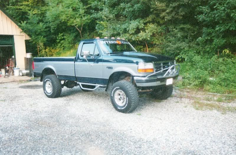

Tom - will this kit still allow us to fit 35" tires with V codes?
Here is my old 97 w ORUs 2.5" RSK and stock F350 springs and 315/75/16s on 16x10 wheels and it rubbed NOTHING.

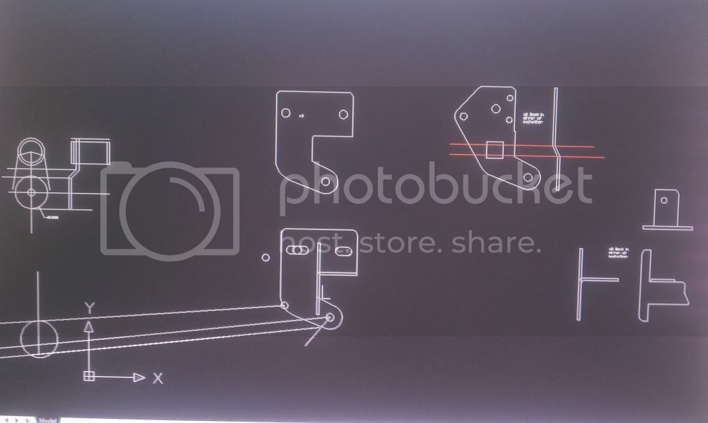

Here is a pic of the Cad file. I still have a few changes to make but this is gonna be pretty close. We will be using a square center section, with optional tow hook mounts to that. Lemme know what you all think!

Yes, a new rear front spring hanger.. thats whats shown on the link, this is to correct the shackle angle from the use of the SD spring..I've been trying to get them to make this change for years..guess they finally had the time to have the engineer look at it as everything they do has to be checked and get his aproval. I wasn't aware they were also making a change to the front and am not sure this will clear the bumper as Trevors will. I do know this will still give 3" of lift..min amount that Sky feels will work.
