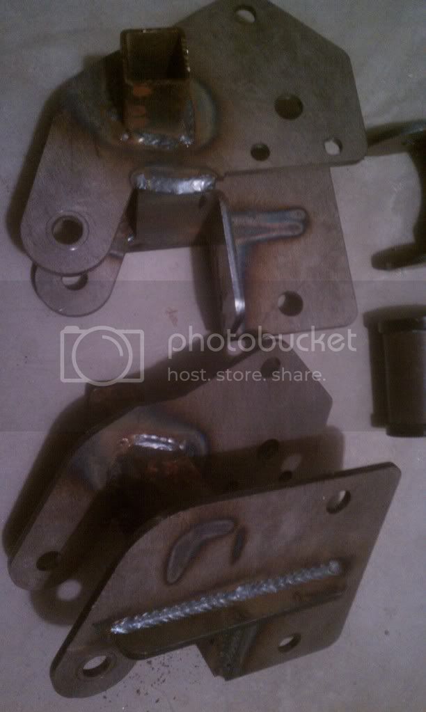

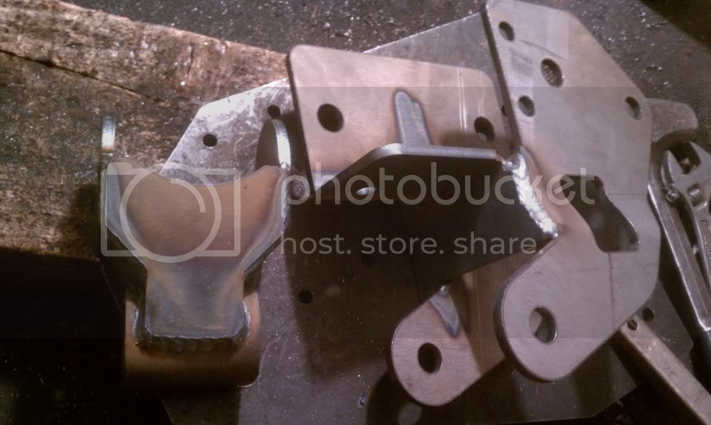

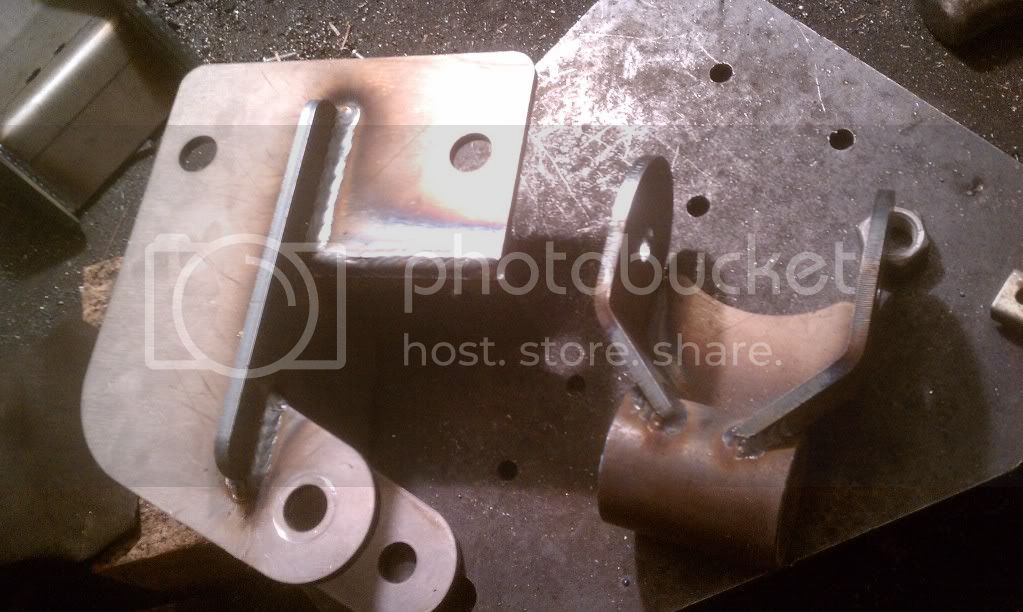

I shipped the first kit to Larry since the timing for Tom isnt great and Brad is out of town. Here are some pics for you all that have been so patiently waiting. Let me know what you think!
