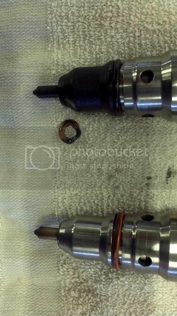

let me guess, you were tossing fuel out the exhaust and a choppy idle, if it ran at all...
so your injectors probably looked like this...
this particular one was due to the fact the guy felt the need to hit the injector with a hammer.. knocking the copper off and crunching it...
do like i said, push them in as far as you can, than make the boat catch the stud, you may have to hold the boat onto the stud, but then push down on th eopposite side. injector will slide right in.... than torque it...
what torque did you go with the first time??? You can also use a straight edge and lay it across all 4 injectors to make sure they are seated...
