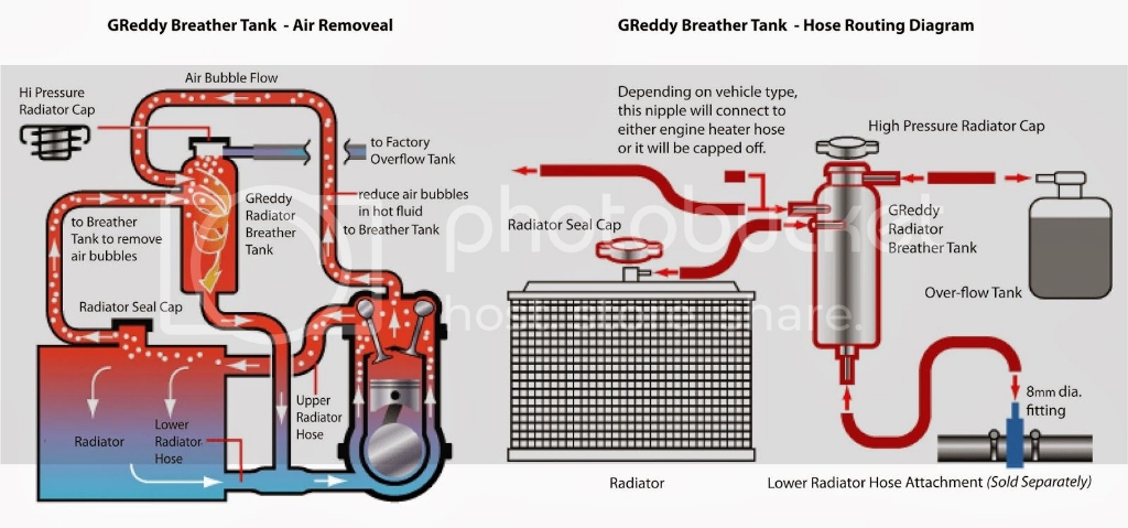

I've built and raced a number of Nissan Z cars over the past 15 years. We use a coolant breather system to remedy these problems with a lot of success.
https://conceptzperformance.com/gre...type-n-fits-most-japanese-vehicles_p_8682.php

I thought the issue we are having is with the intercooler? If they are leaking from factory defects or from high boost pressure I'm not sure a breather is the best answer.
I read number of comments about air bubbles in the system, radiators and the fact that you are running more boost and straining the stock system, which lead me to my reply. The breather tank moves the hot and cool liquid through the system way more efficiently.
If we have the case of it overheating, this will work perfectly, I've thought of a catch can type deal. Thanks!
I think mine is overheating. I'll have to check the CAC and check back. Been too busy to test it.
