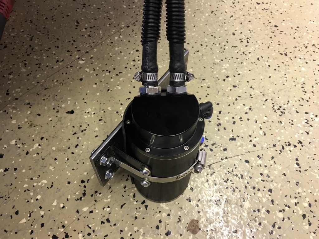

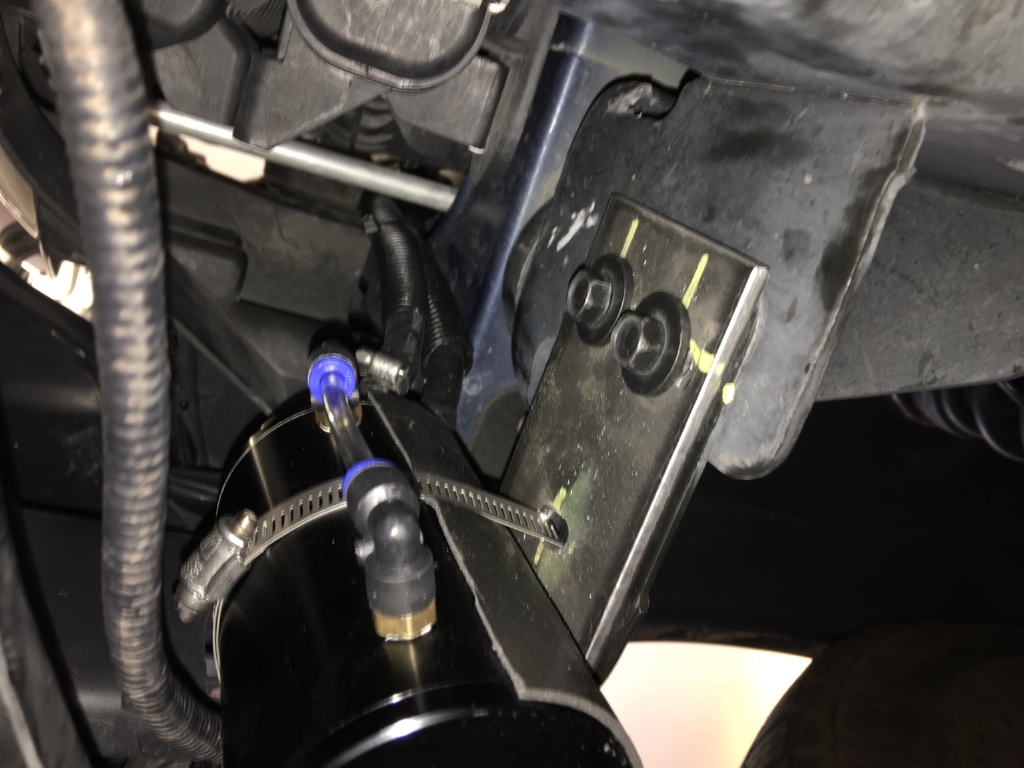

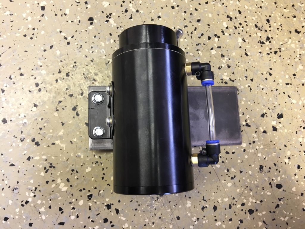

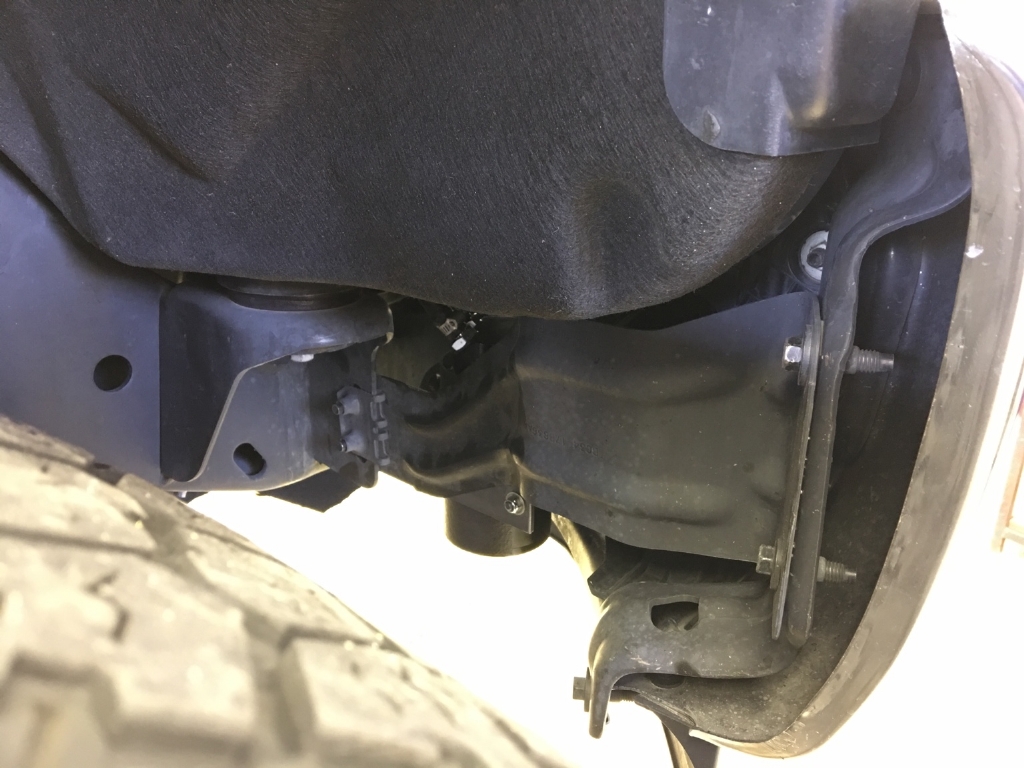

So I made a catch can for my secondary, being I'll be racing in TX this weekend. I can't have it puke on the track.... I'll be able to see how much comes out now and will keep people posted.
Mounts inside the bumper and out of the way. Also allows for easy draining.

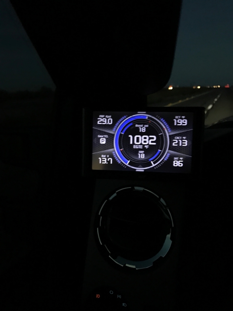

So my CACT temps were a bit toasty coming home last night.
Truck won't puke if I drive normal. It's when it's sustained boost (passing on the I10 at WOT) where boost is at 30+ for 10+ seconds. I just see that CACT just climb FAST
Messing with it this weekend and will report back. Might even go buy a new ford CAC.
Jomax
8,576
9
Arizona
So you were rougly 1/2 throttle in that picture? What should the cac temps be at temp range wise?
Slight uphill, about half throttle got to about 105mph. Temp should be close to the IAT of 86.
