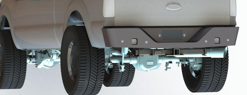

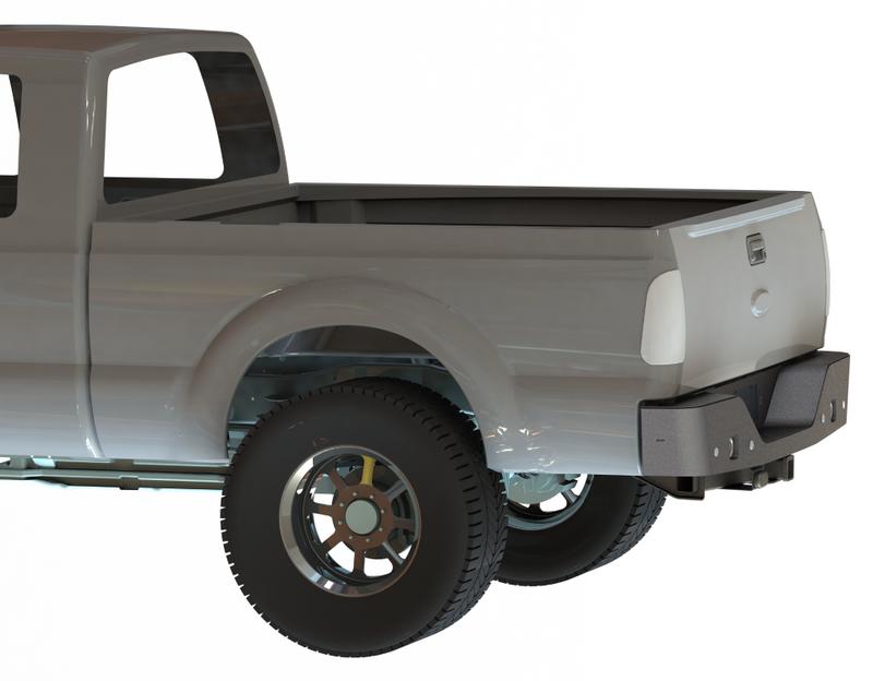

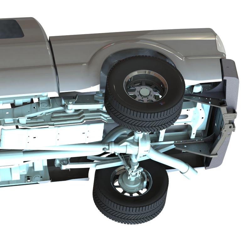

Personally I like the wrap around, integrated hitch, steps in the corners (not shown). But I'm responding to market (here) and making the stock replacement looking one first. Design is done, going to get material cut next week.

I like this one better also. Simple and clean. The corner steps would be nice, but might collect with crap too. One problem that I have with the factory bumper is that when the tailgate is down, the tailgate gets muddy. That mud comes from the tires through a gap between the bumper and the box. This happens while running factory mud flaps too. I ended up adding a second flap underneath the body to deflect the rocks and mud but it would've been nicer if the factory could have resolved this.
What do you think you will be selling these for?

That rear looks killer man. I'd say add the corner steps. I have the fab fours rear with corner steps and even being on job sites every day nothing really collects in there.

I looked at a GM bumper today and maybe you could just fab the corners to accept the GM steps. Kinda crappy, but would look factory. Just a thought...

Robin the only thing i don't think i like about the back bumper it the top step pad sloping down in to the bottom one. You are loosing a decent amount of step pad this way.

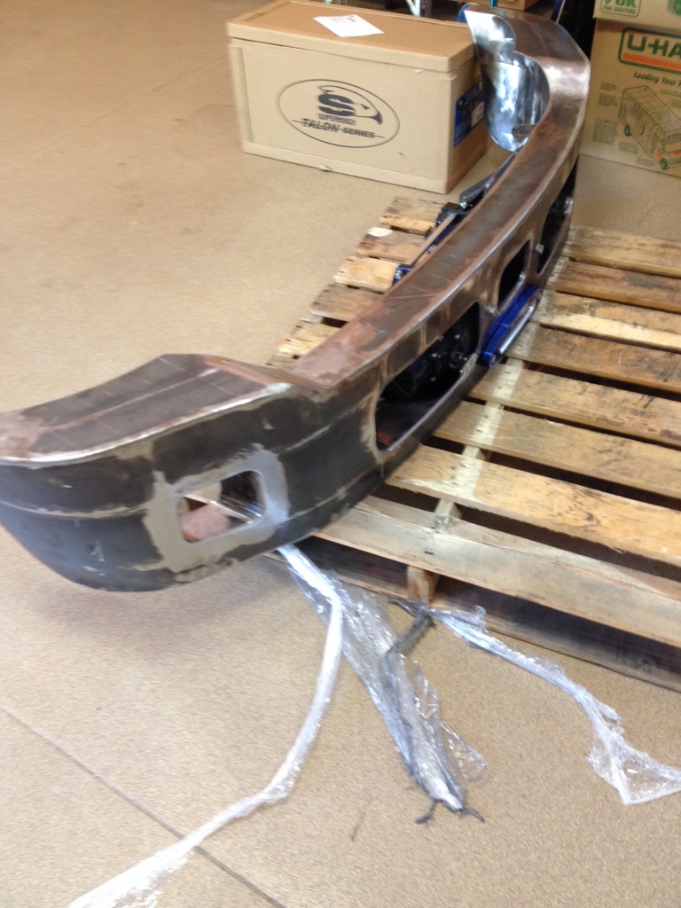

take a picture of where your winch solenoid box is located. I had to do some heavy modification to mine.
This was one of those gotta think 'outside the box' problems. Rather than cutting up the box and trying to weld something plastic back together we simply moved the solenoids to the back of the winch so they are protected and eliminated the 'crap catcher' box. The box wasn't sealed and IMHO anything that's not sealed and used in the mud/dust/dirt simply collects the environment. Just ask any ATV rider. If it's a space and is not cleanable and cleaned regularly it will pack full of mud/dirt/etc. The 'box' didn't do much for keeping the solenoids out of the elements and all the components are sealed components anyway.
Also added a bracket for the plug on the Superwinch. Seemed pretty clean when we finished with it.

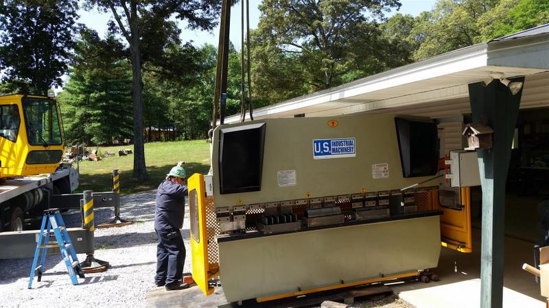

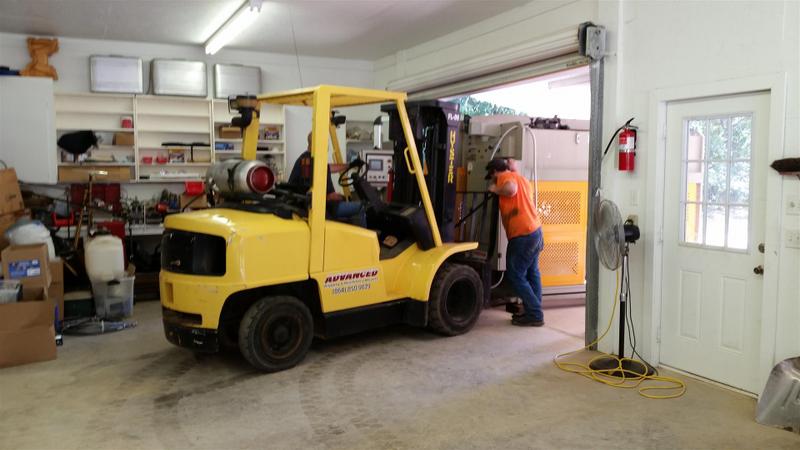

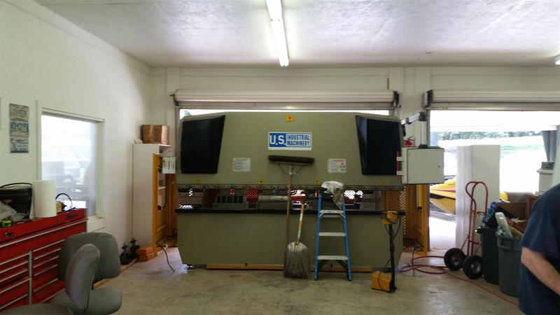

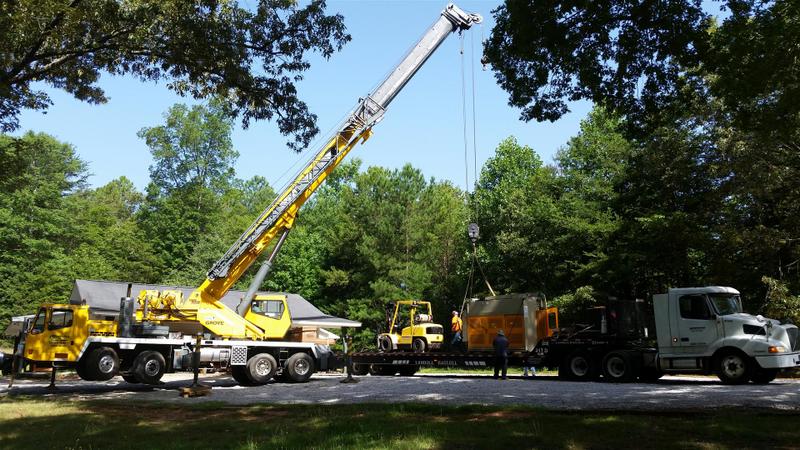

I have moved the brake press to my little shop (1200sq ft) and am working on firing it back up (bolt it down convert it from 480 3 phase to 220 single phase and wire it.) Still need to buy a TIG rig, but other than that have most of what I need to do it here w/o idiot partners screwing everything up and bleeding me dry.

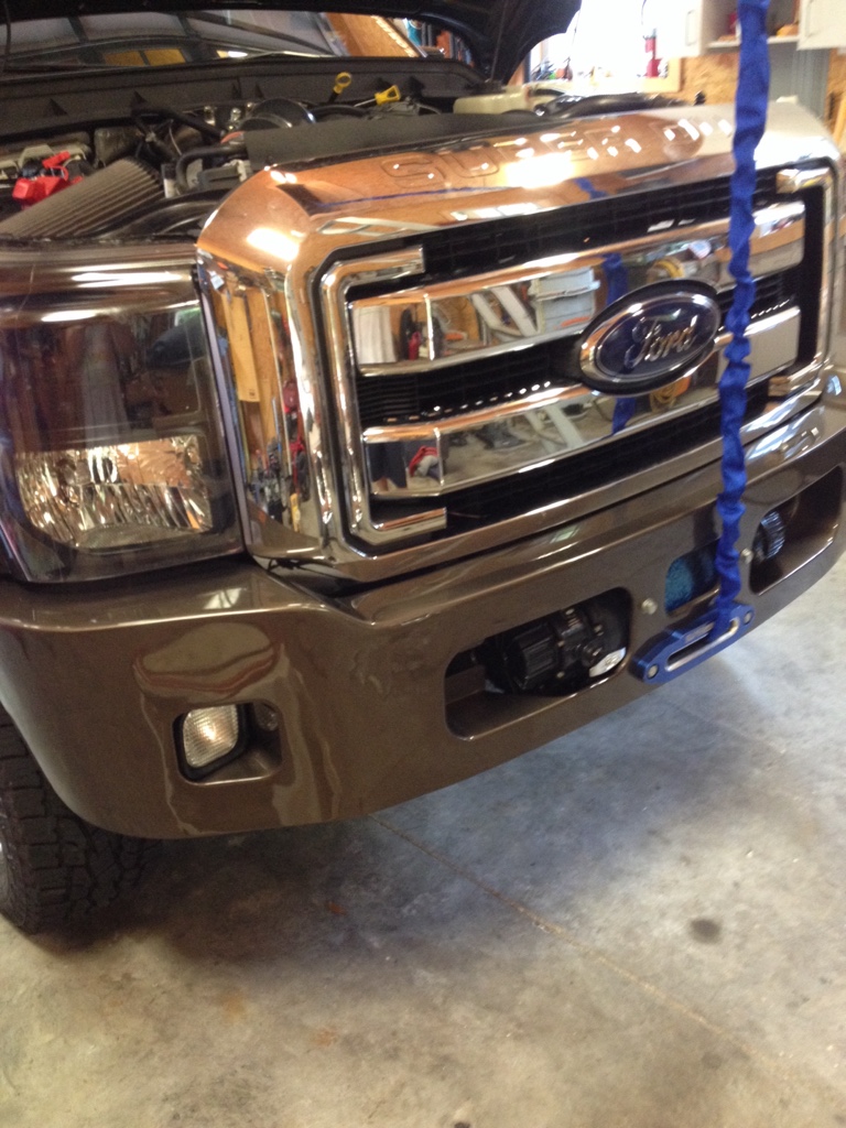

Got it installed last week. Forgot to post pictures. I mounted the solenoid box under my intake and ran the plug to be mounted under the dash. Couldn't be happier.
higherlife
Oct 16, 2014
439
Oh and in the pic above i had the winch mounted upside down so i got to install it twice. :thumbsup: i blamed it on the beer

Post some more pics from further back so we can see the whole thing.

Out of curiosity and interest. How much is the "special deal"? Like the one shown in the pic above.
