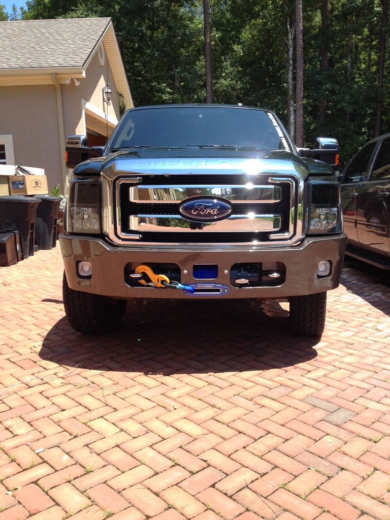

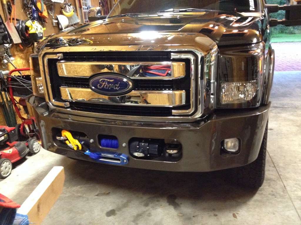

Here's a few more. Don't judge my skinny tires, finally getting 37x12.5 this week :thumb:

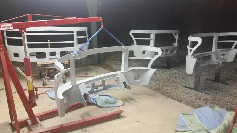

At the moment I have 1 of the 40002HW2 that is complete, and primered with a 3 part etching epoxy high build primer. This is the hot ticket for paint. This one is ready to wetsand and paint. $300 option, but it's ready to spray w/ paint. Note: this is not the answer for a powder coating option as it would have to be completely stripped first.

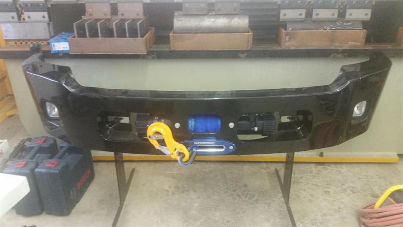

Another stealth 40002B which is done in gloss black powder coat.
Then there are 4x of the full bumpers which lack only their center bar decision. So they are 40002HW1 or 40002HW2 or even 3 center bars or more. These are bare.
So, 6x of them in stock.

oh, looking at your photos...I'm pretty sure you have the winch in backwards. Almost positive the winch's motor should be on the driver's side. I'll check a set of instructions tomorrow.
This will cause it to pull in reverse putting strain on the gears they are not designed for. Also the brake will not operate correctly in reverse.
Sorry...

OK guys, I've gotta move these things. These are full production version, no corners were skipped, they are awesome.
I have 6 left, 5 full and 1 Gloss Black powder coated Stealth.
keeping one for my truck (replace my 2nd proto) but the rest are up for grabs.
I just sunk $1500 into 3part etching high build primer for all of them, so you'll get them ready to block and paint.
