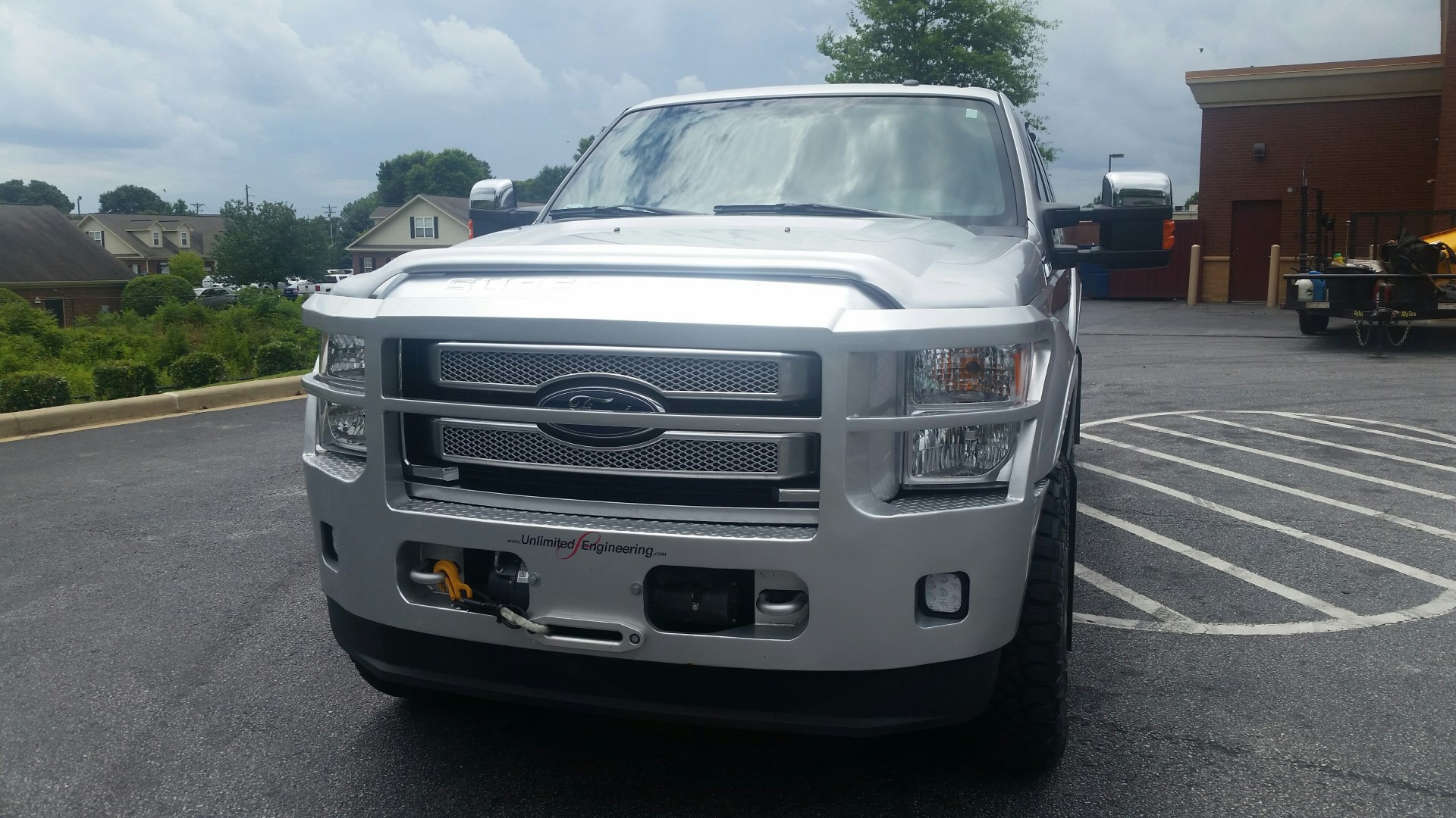

Receiver size is 2.5 as stock.
At the smallest point, the shelf is 2" wide and 3.5" tall. On the corner it's much wider.
Access to the drawbar pin is from the underside above where the safety chains go.
Running final FEA now, but it's way way stronger (last I checked I could hit it with 5x the force of the stock one) than that stock tinfoil pretzel that was twisted up under my truck when it was rearended.
