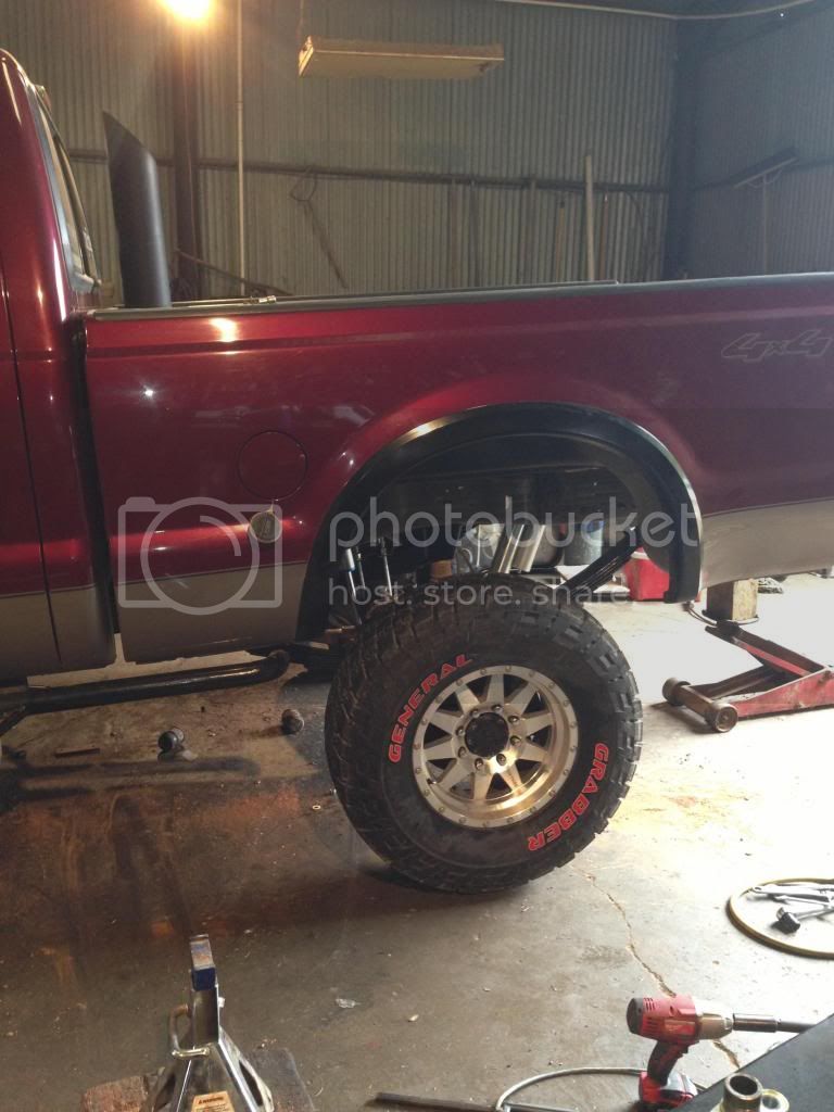

Im going to put traction bars on it that will allow articulation at some point.... but that takes time and the more time I spend on this truck the less time I have to make money... the less money I make the less parts I can buy...... right now Ive been spending to much time on this project if you get my drift lol

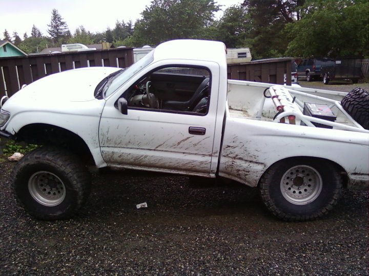

What about a "torque arm".....follows along the driveshaft, really shouldn't mess with articulation or travel......although I wouldn't mount it to the back of the t-case, like they did in this pic LOL

Well I was going to mount my bypass shocks On the traction bars (they are going to be built like radius arms) so the shocks are less travel and are further up in my bed cage. But I haven't finalized anything yet. But I would think sand will complicate a axle wrap issue

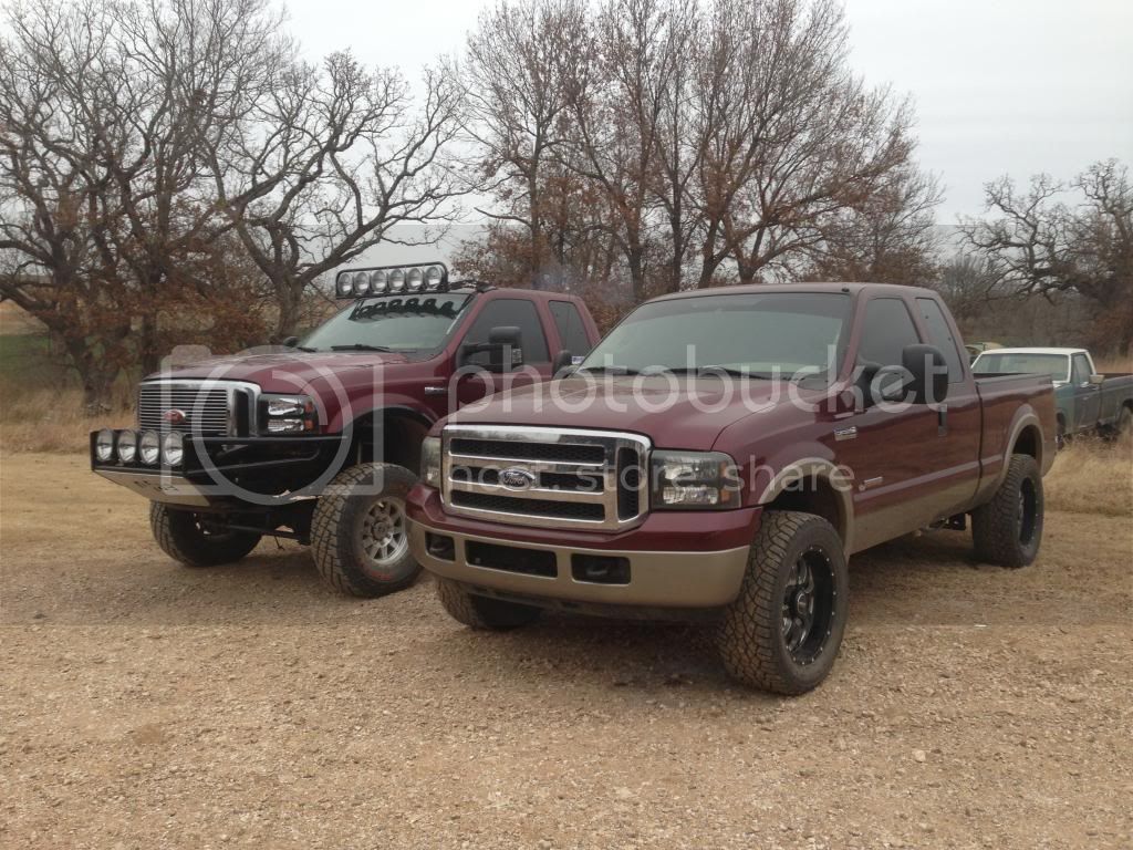

put the truck to work today since my 05 is in the shop being used to fab up some parts. The trailer even unloaded seemed to aggravate the vibration is why I brought this up.
some pics of both trucks when I had them both out.
O2ShootTheJ
3,567
lookin good man! I think if you ptm the grill on the regular truck it would be a knockout!

I had a truck with similar issues after swapping leafs in the rear.
Static ride height the axle was completely centered. Under bump the axle would shift forward.
After a whole lot of screwing around we decided that the shackle length was too long. Basically the longer shackle was increasing pinion angle right off the bat and having the shackle at the rear was causing the axle center-line to shift forward under bump. Both were contributing to bind in the drive-train.
I'm sure I'm over thinking things, and you've just got a little bit of axle wrap going on, but that's how my brain work.
Did you do anything to the shackles when installing the Deavers?
