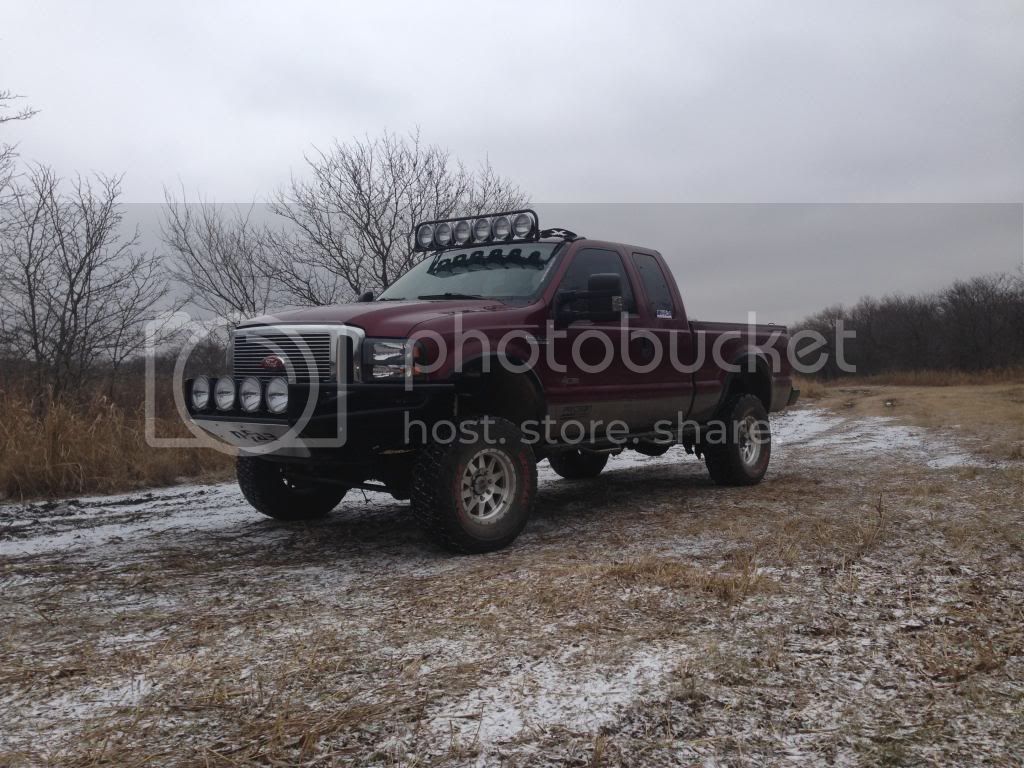

went out and did some off roading today with it to just enjoy the set up some. Just some core ground and has alot of trails around fields and alot of rutted up places. I cant say enough about how well this thing performs! If I was doing this in a normal superduty i would just be crawling across it. With this thing I can fly and do it sideways! I never felt like I was going to fast for the terrain. at some points where I knew the trail pretty good I was going 60!
You can only use about 1/2 throttle off road without the thing just going absolutely crazy on you lol

You should mount the GoPro next time! Watching your build has me wanting to do something similar! I've been looking at a lot of prerunner sites and watching videos. Always been fascinated with suspension

As I was doing it I thougnt about it. Haha I was on a test drive after adjusting the suspension and it was kinda a spur of the moment type of deal.

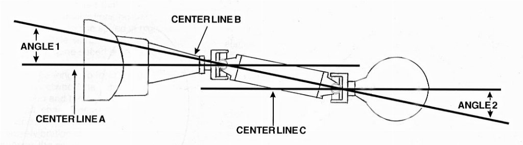

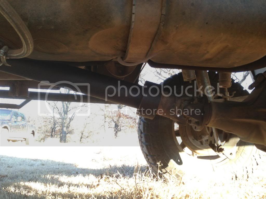

So when I get on it hard I get a small vibration. I'm thinking it has to be in the drive shaft.
Any ideas what would cause that? To much angle?
I have a scsb so one piece drive shaft
JMart
3,401
DFW
Put your traction bars back on. :doh:
I bet those deavers are wrapping up and causing a bad angle.
Cutting-Edge Diesel
Feb 10, 2012
5,738
Newkirk, OK
I was wondering if it was wrapping the alxe when I got on it since I have alittle more power than most with this set up and the leafs are on the softer side.
