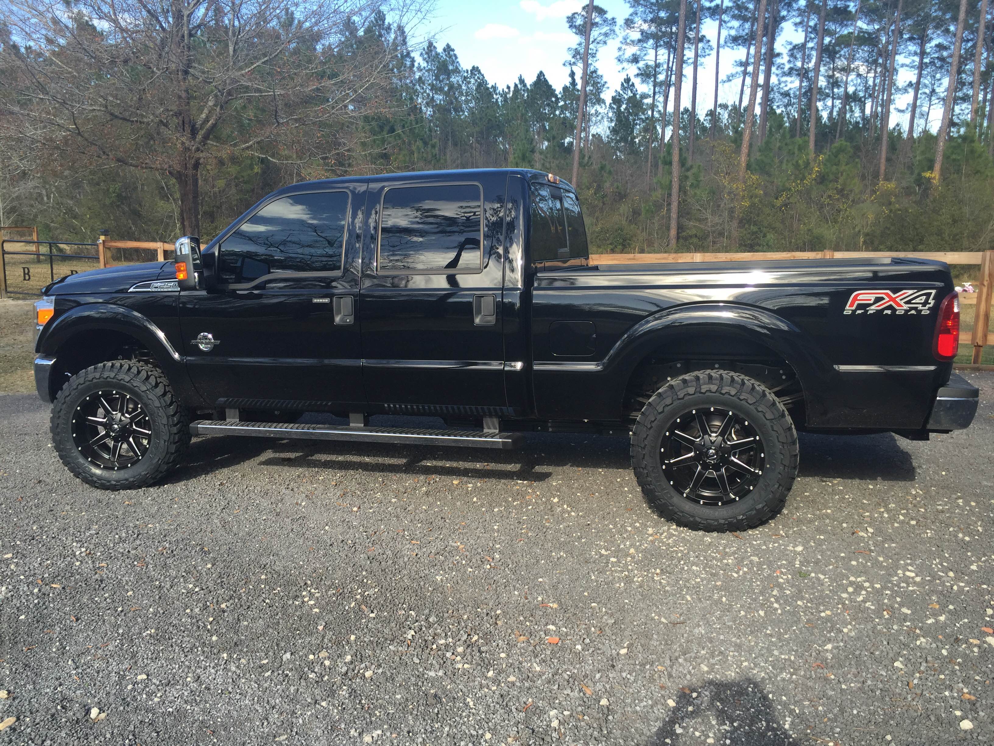

2016 with 2.5" ready lift in front stock in rear. 20x10 fuel mavericks -24 with 35"x12.50 toyo MT's.

I had to cut off the bottom part of the bumper brackets and it rubbed the back part of the wheel well but that was just cutting that felt stuff with a knife. ............. I guess that's also another question I have for anyone, how do you measure the rake of your truck? I have been told a few different ways but what is the best way to measure if your front and back is level or not?
