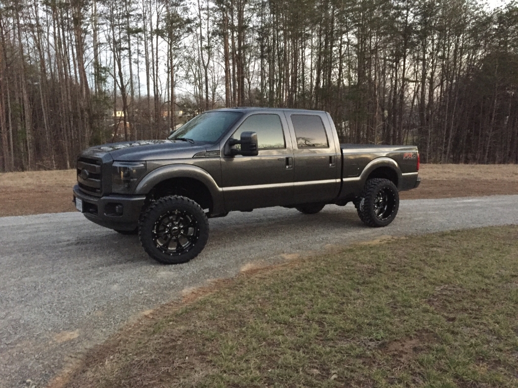

Love your gray truck thats the color I wanted LOL
Carli 2.5" coils American force Rebel 22x12 toyo open country 35x12.5
2" Rough Country spacers up front with 5100s on all 4 corners, stock 250 block in rear. 20x12 gears with 305/55 AT2's. Front bumper bracket was chewing up the outside of the tire pretty bad so I grounded and smoothed that down but still seems to catch at full lock but I'm leaning towards either the 2.5 icon or carli kit with a 4" rear block that I'm hoping will fix it. Rudys this weekend isn't helping the fight I've been holding against ordering a bunch of parts....
Looks Good. Do yourself a favor....Get Icon 2.5" Springs, ICON Track Bar, Some good Fox or Icon 2.0 Shocks and a 4" Rear block and you'll be dead level. 5" Block if you want Rake. And personally I'd hit Jared @ OUO up for some OUO ALA's in the front for a 3 link, It's amazing how much the ALA's help out
Not all will be dead level. I have Icon 2.5" coils and was still 1/2" low up front.
wow, I really like that setup
I just like detailed information. It's what I work with every day. One mans "dead level" is my 1/2" low just like one mans "it clears" is my "rubs like crazy".
