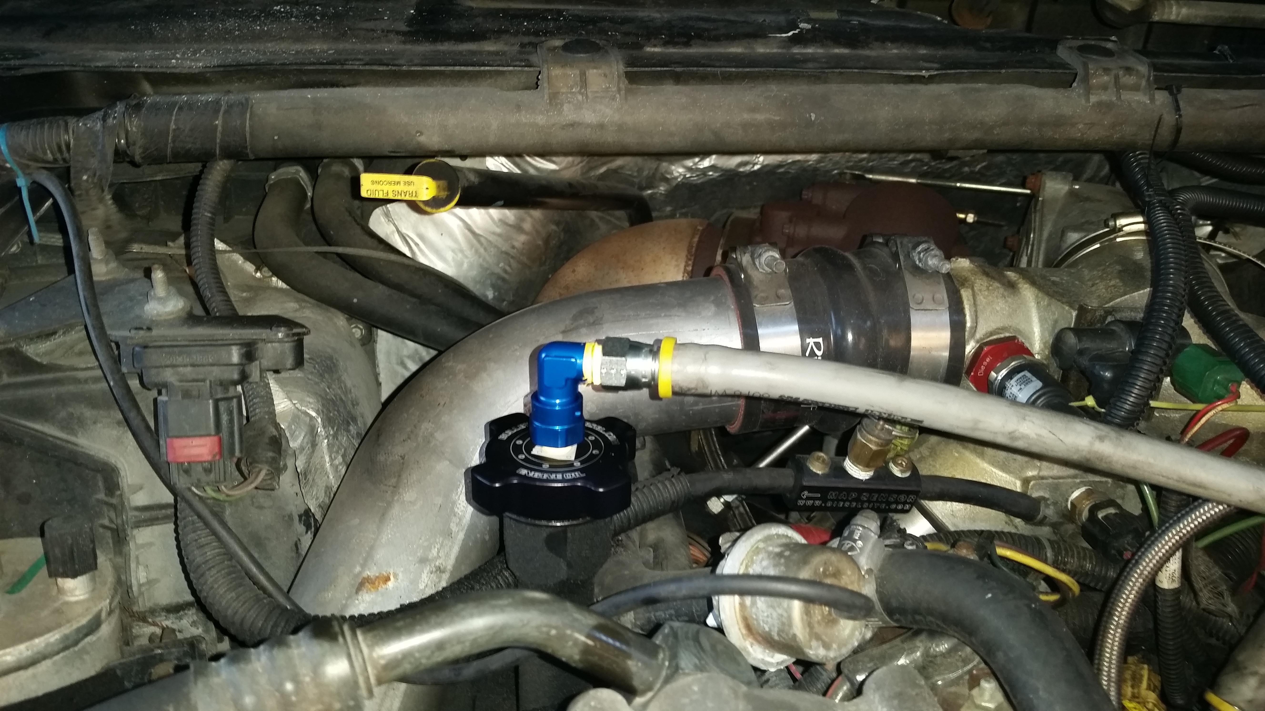

I am building the kit right now for testing. Id love to test against the fs2500. That's probably the most popular kit on the market right now. Let me finish the tests on my truck first though. Also, anyone have an idea about a return that doesn't go into the cap for a cleaner install?

Still clean this way in my opinion.
Honestly that's going to be your easiest universal way of doing it, may not be the most cosmetically clean way. But beyond that will require modifications that may be beyond your average consumer or beyond what they are willing to do to run the kit.

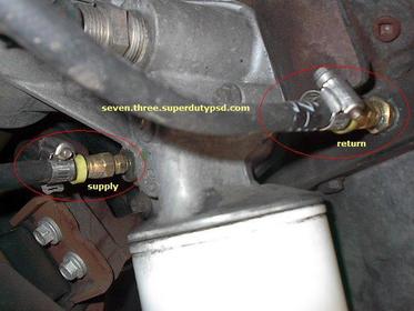

A option for 7.3's would be like the amsoil kit where you punch a hole in the oil pan and screw in a fitting.
The fitting itself is BP40.
Sent from my SAMSUNG-SM-G890A using Tapatalk
psduser1
3,864
42
on the road
Something like this.
What size is your return line? Text if you prefer, jim.
