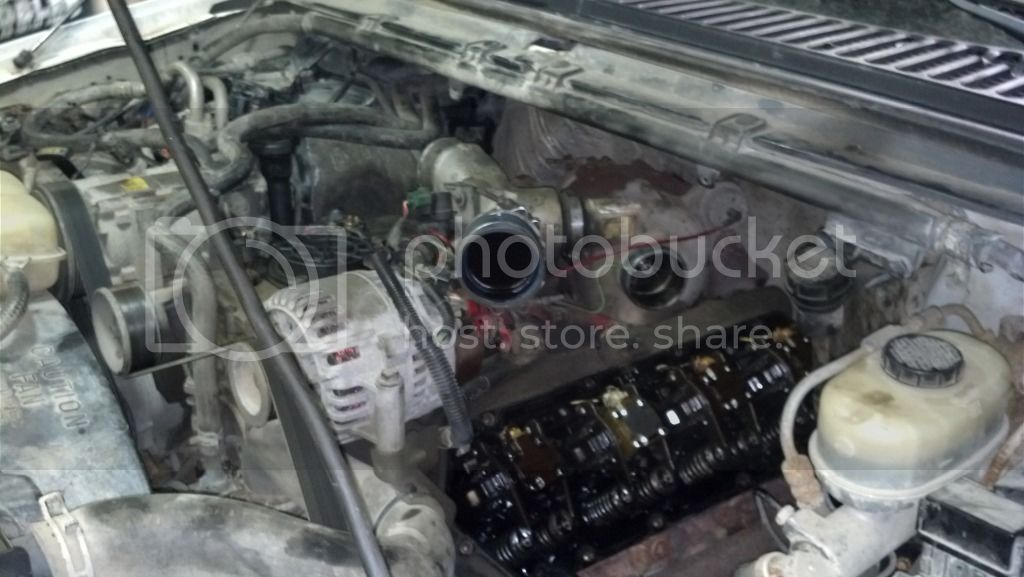

well update:
got the injectors in to no change. thinking its a compression problem. ill run a compression test when i get the chance. thinking the injector sleeve is a little goofed up on a couple of cylinders as a couple injectors had the black soot on them from a leaking seal.
idk. im dont for the night. 5 hours of work and absolutely no change at all. Im done

just some pictures i took

That sucks to hear, did you look at the push rods or anything while you had the valve covers off? Any noticeable thud sound through intake or exhaust? Any chance you have a bad injector(s) in the new bunch you put in?

I didn't notice anything noticeable. Everything seemed to work right. Not really a big chance the guy I bought them of had them checked at a diesel shop and besides a little bit of sticking they were fine.
I'm gonna try a compression test today and see what it turns out

It runs!!!!!!! It was the injectors not torque down tight enough! The haynes manual was not right on the torque. So I went down a little more and the cylinders that were not firing are noe all firing and it runs great!!!
