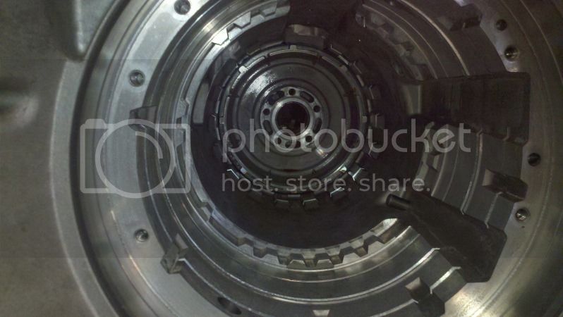

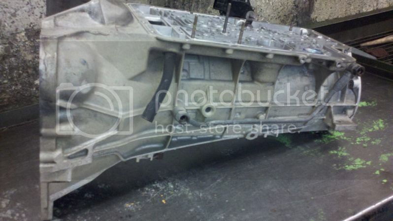

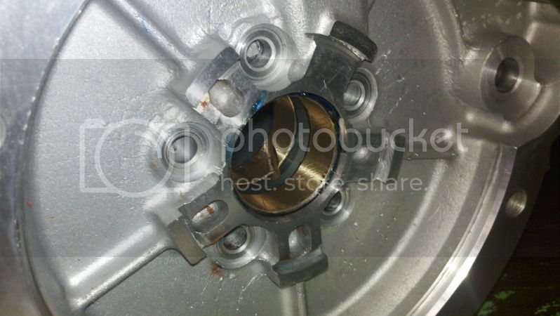

one piece rear bushing

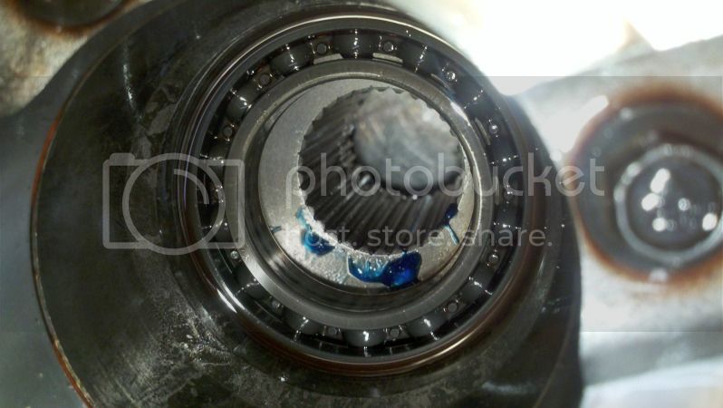

this is the stock 4r100 forward drum

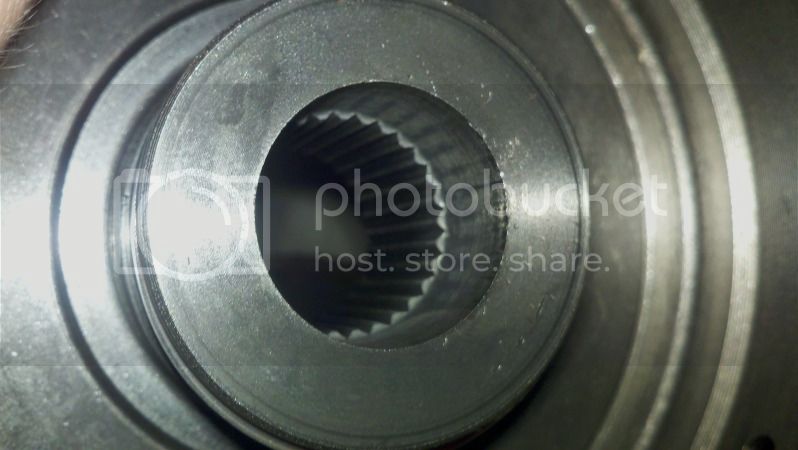

the fully splined e4od that is going in.
the stock 4r100 tin can low reverse drum on the left and the cast e4od that is going in.

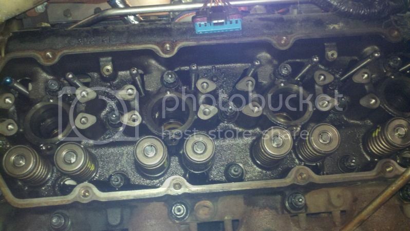

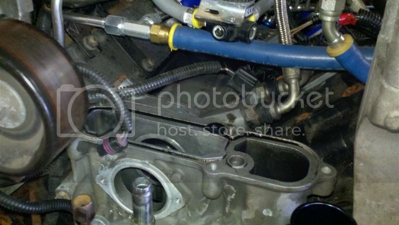

Simply remove the stock bolts and put the studs in. LOL
orthographiam recte est super occidere
Much easier said than done. You have to do some motor rocking, injectors must come out. Not as simple as pulling a bolt and replacing it. Next time I do it, the cab is coming off.
