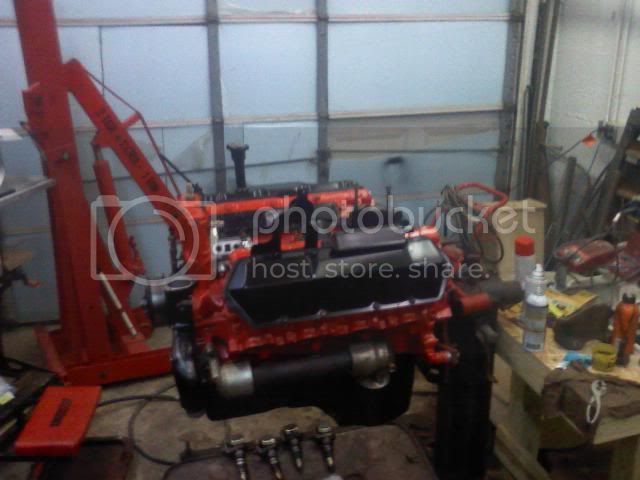

The easy way to stud a 7.3
Chvyrkr
2,205
Its even easier when you don't have the frame and wheels to work around :)
Engine stands are a wonderful thing !

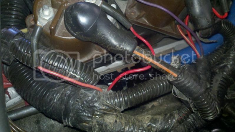

I always pull the engine wire harness off to, doesn't have to be done as you can just undo the bundle brick but i just take it all the way off
