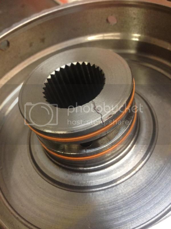

Well me trying to be cheap on my own transmission and putting a used e4od foward drum in bit me in the ass. Lasted about 24 hours lol.

And yes i had reverse and slipped really bad going forward due to the loss of pressure to the apply piston due to the crack. I launched it at 20psi and it just went right to the limiter when it cracked.

Well for now I'm just going to throw another e4od drum in it. So I can drive it this weekend and soon I'm going to drop a billet forward drum and and OD planetary in.
