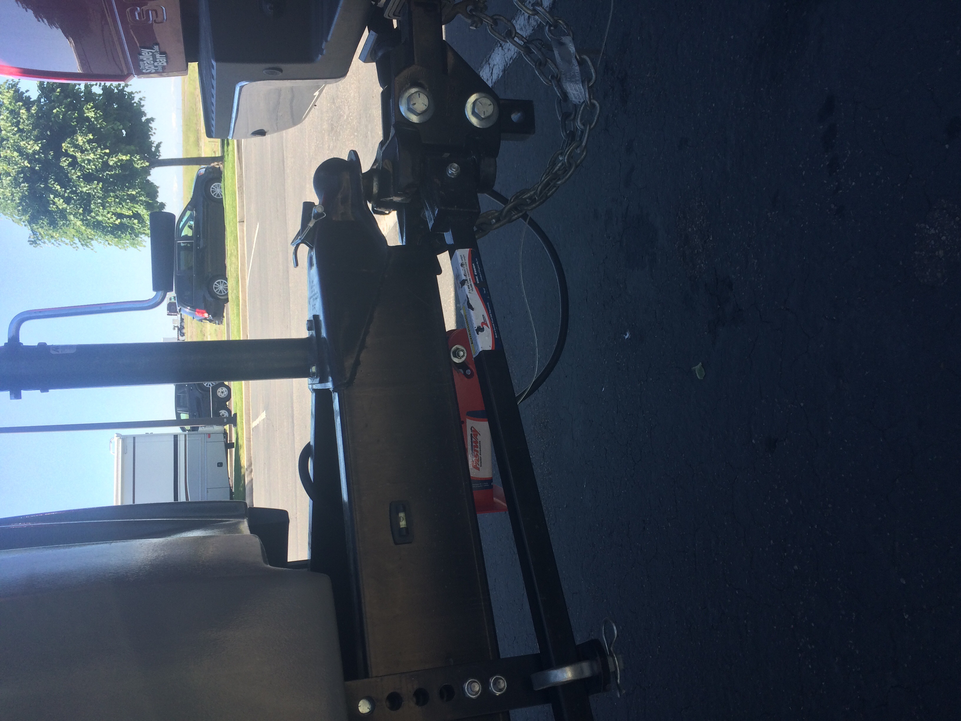

Hopefully the pic downloaded but I have had hellwigs, air bags, timbrens, combinations of both, lowered truck and the sway bars you see in the pic. No matter what you do if you have a big bumper pull the wind will take U where it wants you to go. My only suggestions is run slower 65mph. Hope this helps
