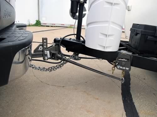

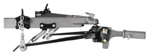

See those links in the photo? Those are the no-sway features of this hitch. It is not just load leveling.

Yes I see them, they won't work for sway. They are in the wrong spot to stop sway.
Once you try it you'll wish you listed sooner. I'm not a sells man. I'm not trying to be a ass. I wouldn't even sell you the big ass hitch. I use a normal drop hitch and sway bar.

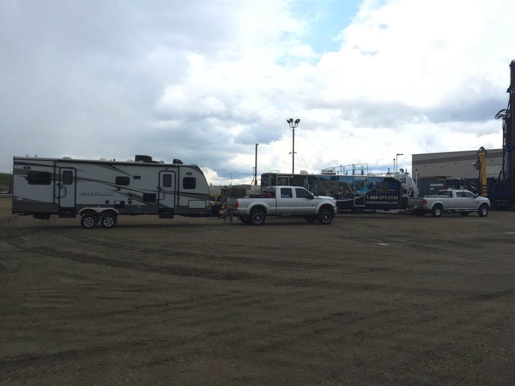

Oh man I didn't realize that you didn't have a combo hitch. I use the blue ox sway pro and it works awesome. I tow both of the trailer in these pics quite often and I have no issues with the trailer wandering. I drove 400 miles in a 50mph crosswind and I was crushing at 70-75mph the whole time. Straight as an arrow. My trailer on my ford is 32 feet and the other trailer is 37ft. I would not buy anything but a different hitch before you do anything else. I originally bought a reese weight distribution only hitch and I returned after my first trip and told them I almost died from trailer sway. That's when I realized I shouldn't have cheaped out in the first place with the $500 dollar hitch and forked out $1000 for the Blue OX Sway Pro. I need to mention as well that I have air bags and with my toy hauler loaded with no rzr and dirtbike in the back I run 60lbs. With the rzr and dirtbike etc in the back I only run 40lbs.
