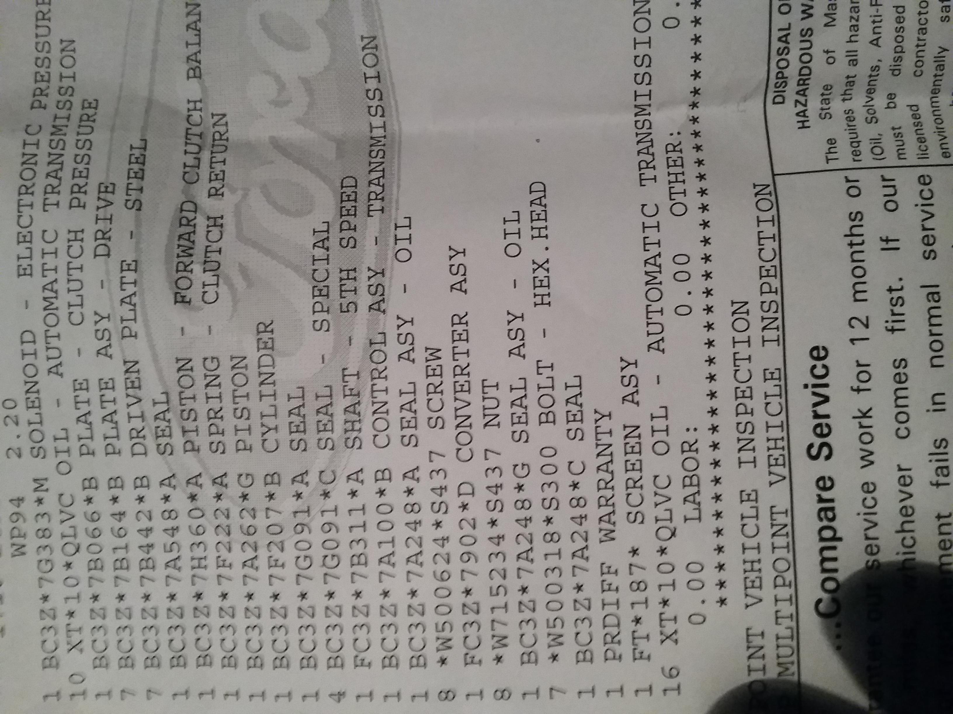

Here we are day 10 of truck being at Ford solenoid was finally installed this morning as apparantly the tranny tech never showed yeSterday. Anyways solenoid didnt fix the problem the tranny is now being gi
pulled to check internals,

Well its day 19 and finally got the truck back here is a list of what was replaced uploadfromtaptalk1423791145606.jpg

Forward clutch is one that they reduced the number of frictions in.
Doesn't show any new frictions or steels? Wonder if that's just lost in their list?
Hopefully they get it straightened out.

Two different line items of 7 ea plates are in the workorder. Got the better part of a rebuild it seems.
