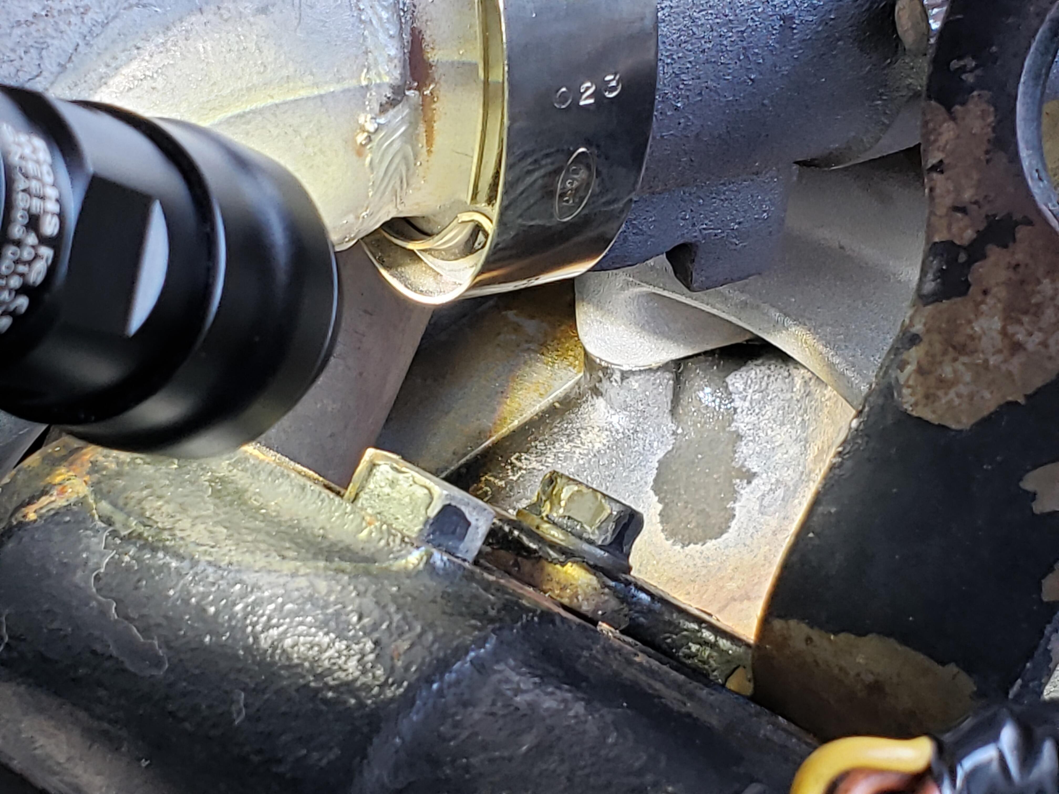

Ok guys, so I've been keeping an eye on things with the current pedestal installed... the seeping I was seeing has progressed ever so slightly. I've driven the truck a total of around 225 miles between yesterday and today, with the bulk of the driving being a 150 mile trip yesterday at around 75-80mph for half of that. As you can see it's still seeping a bit, but even after all that driving it still hasn't even made it down into the bottom of the valley. It's still clinging onto the vertical portion at the back of the valley. The gf and I are leaving for a 6hr drive tomorrow and at this point I feel safe driving it, but wanted to get a second opinion. What do y'all think?
Tia.

Thats a leak, definitely shouldn't have that.
Id still drive it.
No other input, I guess, except maybe the mounting surface isn't flat?
Are you sure it's not running down the back of the pedestal from the turbo itself? As in from between the turbo and mount? There is a shadow at the top right of the pic-top of the mount-that looks wet. Maybe just a shadow? Itll take a mirror to see back there.

Try cleaning the **** out of it with brake cleaner and take it on about a 10 mile spin, driving it fairly hard, and see if it comes back. Could be residual, seeing as it ain’t real big. If it does come back I concur with using a mirror and making sure there isn’t a turbo issue or something. I’ve been burned on a couple I thought was the pedestal leaking and when I got it off and apart, found the bearing housing in the turbo was cracked. But those were typically leaking much more than yours is

Well guys, we made it to our destination! I cleaned it well with brake cleaner before leaving, and after over 6 hours on the road with a few stops for fuel and provisions along the way, loaded down with 2 adults, 2 giant dogs, and lots of luggage, and traveling at speeds of up to 82mph and reaching boost of up to 12-13psi (maybe more during hard accelleration), the oil spot has returned under the pedestal. I confirmed that it is NOT coming from the pedestal to turbo o rings, it is for sure coming from the pedestal to engine o rings. That being said, after all of that driving under the conditions described above, the oil spot is only half the size that it was before. With it being such a small leak, do you think I just need to tighten one of the pedestal to engine bolts a bit? Or is it possible one or several are overtightened, and that's causing a leak? I'm at a loss...

Maybe double check the pedestal bolts, clean it up again. Sounds like it is better, possible its residual.
