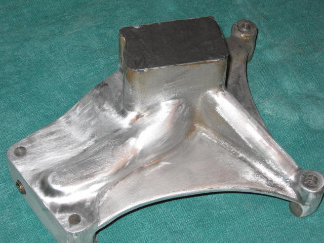

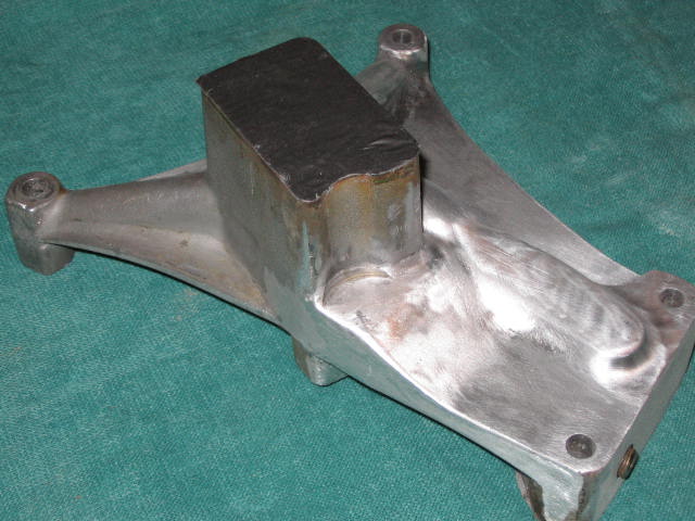

I modified a stock pedestal on my 94. I had the openings welded up. I attempted to make it look halfway decent (the duct tape is just to protect the turbo mounting surfce). Cheers!
