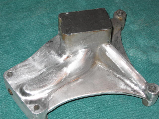

I know if I ever get rid of the EBPV on my Cali 97, I will only get a genuine Garrett non-EBPV pedestal. At any rate I modified my 94's pedestal way back in the day. I had someone weld up the holes and weld in some plates to cover the large opening from removing the actuator cylinder. I was trying to make it look decent and not be hacked up looking. Cheers!

Ok... so it looks to me like you closed up both holes that the oil passes through. Is that right? And if so, wouldn't that damage the turbo running it like that with no oil?
That looks good!
He removed the "damper"- the butterfly part that stops exhaust flow. Oil flow is bottom to top, and vice versa, for supply, and return, respectively. Those ports are covered with tape in the pics. His pics are showing the weld "repairs" on the side of the mounts.
I did it magnumpd's way. Just not quite as refined, but effective. If I remember tomorrow, i'll get a pic. I think I've still got one on the shelf.
Aug 12, 2011
459
13
Parker, TX
Oil passages are still open, both supply and drain. The duct tape on the top was to keep filings from getting in the passages. Closed up the solenoid hole as well. This was on my 94, so no Cali versions at that time. Cheers!

Ooookayy gotcha. Yeah I didn't realize it was duct tape. Lol. When you said you welded up the holes I thought you meant those too and I got very confused haha.

Ok yeah it was the duct tape that threw me off lol. I thought he had welded those oil passages closed. :doh:
