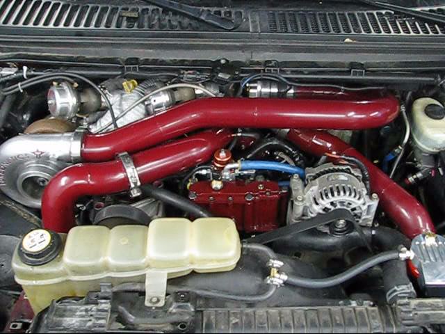

quick pic i found, of a setup made by Empire.
as you can see, there is no cooling between stages, only between motor and hp.
compressor side. from intake which is now on the left, through the tube to the intake of the hp turbo, through the ic, to the motor. the "plumbing" for that is almost identical to stock, except that the intake is on the left now, as opposed to the right, and another turbo where the air filter was. :D
exhaust side. from "headers", through up pipes, into hp turbo, out the hp turbo, to the atmo turbo, back to the regular down pipe. you can see the various gates there as well.
its unclear in that pic if they retained the A/C or not, though its been said, that if you mount on the ac bracket, and relocate the pass battery, there is enough room to keep the ac for summer use. though i suppose the size of the atmo would also dictate that as well.
it would be a viable option, as well, to relocate both batterys to the pass frame rail, put the atmo turbo up front on the ac bracket, and instead of putting the atmo straight into the hp turbo, putting a air to water ic where the drivers battery would be. using that pic as a general, plumbing that would not be that much of a hassle. as the odds of another air to air is slim to none, on the amount of room we have up front.

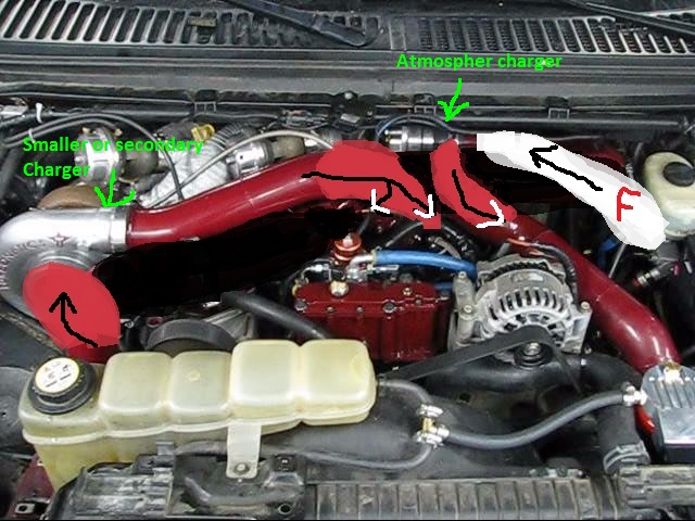

Ok, here i altered the pic so maybe you could understand a little what i ment if you already havent. And from reading your respones makes me still believe it can be acheive. Do this kind of piping but switch the chargers around so that the atmosphere is sitting in the valley and the smaller secondary sitting out side on top of valve cover or where ever you were planning on putting the atmo.

Here it is with labels. This is done in paint so dont bust my balls.:pointlaugh:
I dont see why this wont work, the atmosphere will get the exhaust first. Sounds to me that could be beneficial.

The problem I see is the small turbo being a bottleneck. The idea is for the small turbo to light quick then let the big turbo take over. When the big turbo lights its going to pull more air than the small turbo can push (atleast that's how I see it and I am not a turbo expert so take it with a grain of salt from another member trying to learn too).

The pic is just air flow, the white part is where the filter would be with the be red f. then just follow the flow, i was aiming at keeping the flow stockish like the truck would sit normally. Then flip the chargers around like i have labeled in the second one.
cfdeng7
1,369
CT
Ok so you actually want to mount the big turbo in the valley. I thought you wanted to have the small turbo feeding the big turbo idk why. I'm tired haha
Your brain is a grain of sand. LOL jkn...Im seeing where the other way is bad, but the last two posts are aimed at swapping positions of the turbos around to see if that could be better. Still the same flow, just easier to pipe it that way, as im seeing it in my head.
