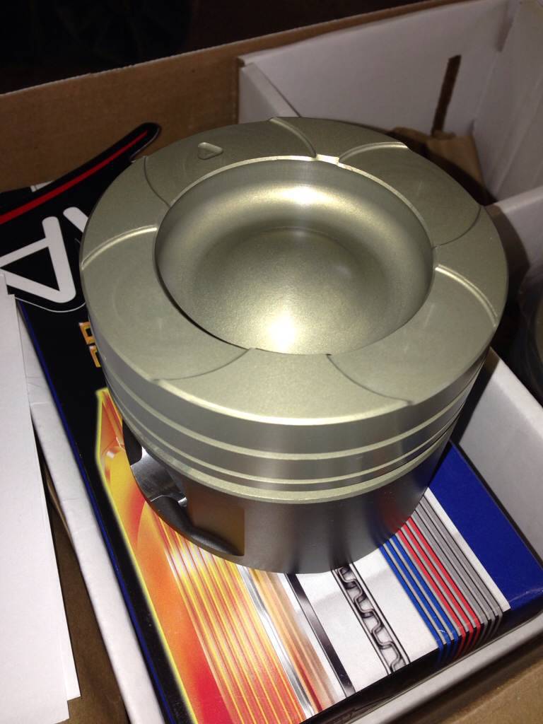

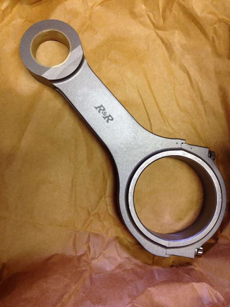

I'm pretty happy with my build list, although I do wish I would have done forged pistons. If the aluminum heads prove themselves they would also be a great addition.
