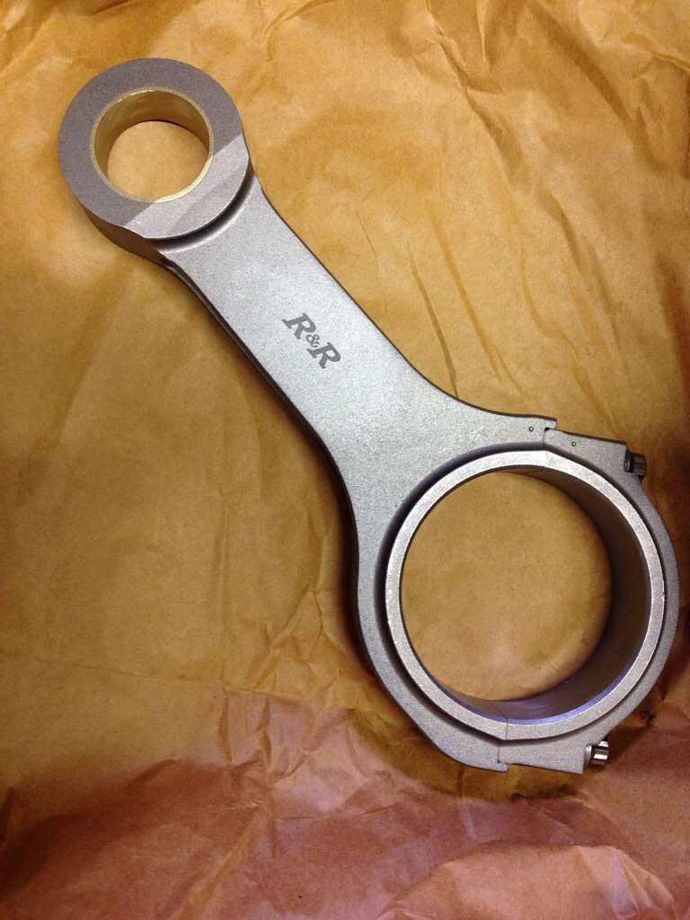

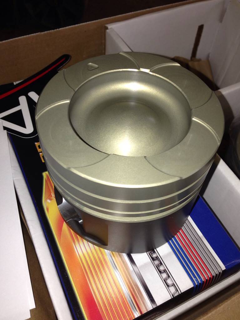

This
This
This
This
This
All of these
And hopefully not this

This
This
This
This
This
All of these

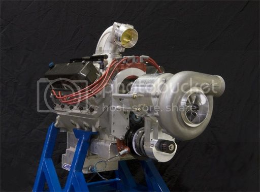

Maybe even a race drive F3 procharger

How much power does it take to run a big procharger? Don't think you need it. I would be leary of a stroker kit, these heads don't flow enough to support the benefits, IMO. Ohh and you probably wouldn't get it til next year.

450-500 base motor hp. Thats one big problem with the procharger is your motor has to make so much more hp to drive it. It would make power if you could keep it together.

no way in hell a pro charger takes 4-500 horse to drive. more like 100 .

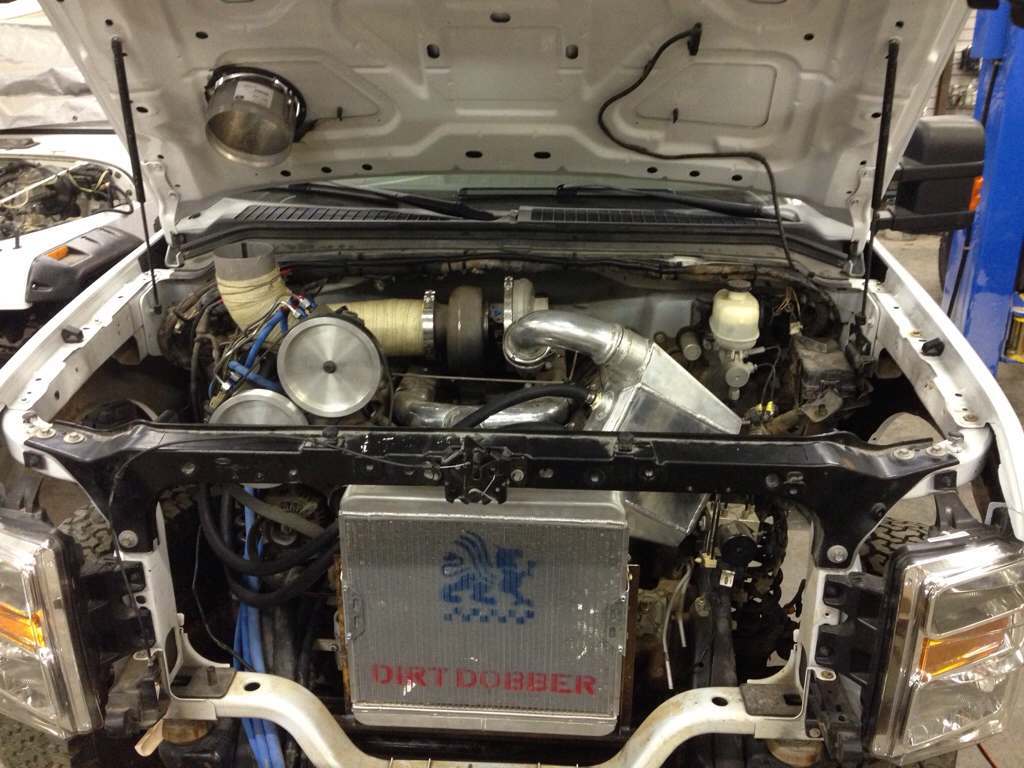

I did a lot of stock parts removal and simplifying. Removable front clip was one of my favorites.
The build for this season consists of.
Forged pistons, lightened crank, billet rods, balanced, aftermarket heads (water cooled, they are on a few running trucks now and do work) thinking of steel sleeves in the block and might full fill it and just run water through the heads. I will be leaving the stock oil pump, they are plenty large enough, even after a run with hot oil it carried 50 psi at idle. May do a vac pump of time permits. Custom intake plenums and larger ice/water to air intercooler.
Dual pumps, 100% and large compounds, spray the rest. Trans will be your weak link anyway.
