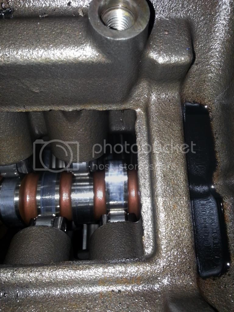

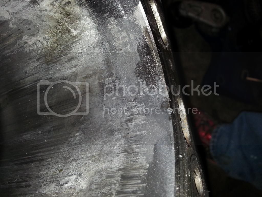

Since every time I post it is good news......
[/URL]
[/URL]
Time for a new block
The wear in the cam you can feel with your finger, a lot of material was worn off

I have not seen a 6.4 torn apart so this might not matter.
Does the cam bearings go in clocked or can they go in any way.
