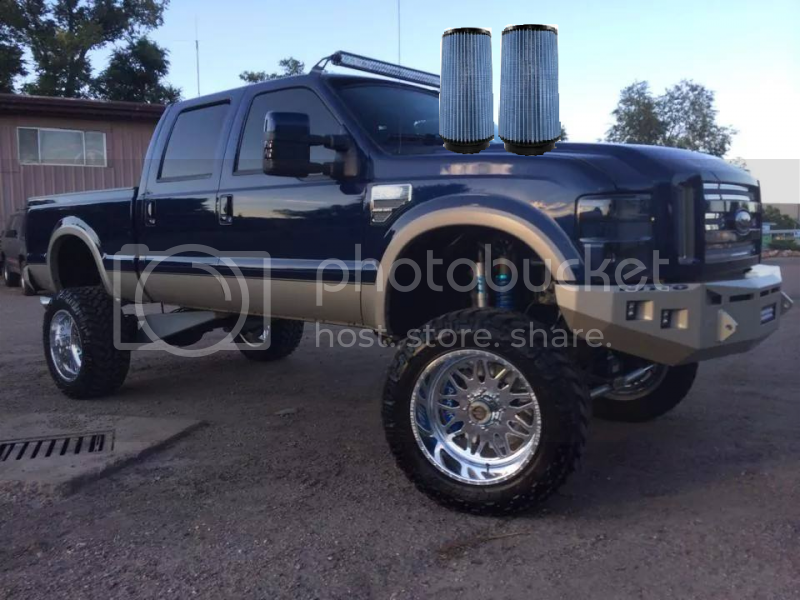

better solution, would be to figure out how to split the intake tube, or put a "Y" in it, so yo can run two filters.
no sense in taking away air, just let it breath better.

its only a concept design. feel free to use it erik. you're welcome
Holly ***sticks!! LOL
That "y" idea is good but don't know how to fit that anywhere. I will know more about it late today when I talk to Mike, but I am on the road tomorrow at 6am!
