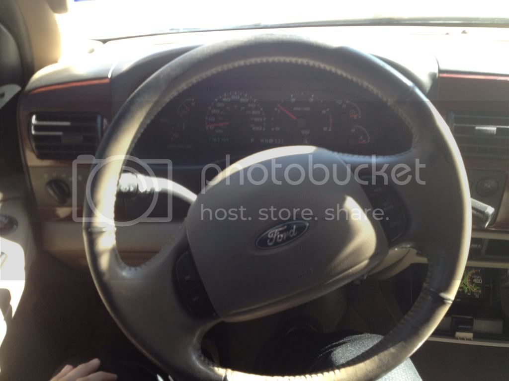

Picked it up and heres where the wheel wants to sit.
Gotta find the box I want order it and take it back when it comes in.

theres an adjustable collar type thing down there, loosen up the two bolts and twist it around and the steering wheel will go one way or the other. Or just take it in for an alignment and they'll straighten it out
FX4 F2-Fifty
673
East Houston/San Marcos
This. Set the wheels straight and adjust it. Its on the link that comes off the Pitman arm. I found it easiest to adjust when I loosened the two bolts and stuck a stubby screw driver and rotated it.

Those pics are after the alignment was checked and it's still set properly. The truck doesnt pull but the steering wheel rests there instead of at 12 o clock.
The sector shaft got twisted in te box

yup they should have included that service
I am confused you stated you twisted the Sector(vector) shaft ?
what exactly are you talking about they just don't twist without drama and they actually usually snap
and it wouldn't technically affect alignment

I'll check into that monday. I'm really not opposed to replacing the box itself as the steering has been kinda loose.
The guy that looked it over discussed it with a major ford power steering guy in Houston and that's who confirmed/pointed him in at direction. The guy who looked it over is legit as I have the truck on me and it's not being held hostage etc etc.

I was told it was the sector shaft. And it was the reason that the alignment is just fine but the wheel is off like you said the sector doesn't effect the alignment. I'm driving the truck it's just annoying that the wheel is off. It will also buck slightly when turning right not much but can be felt.
I was also told that in the area ford sector shafts are back ordered plus it's more expensive to just replace it vs the entire box.

I would think its more likly you bend the tie rod, panhard bar or damaged the panhard bar mount versus twisting something in the box.

but that would have resulted in it not being able to be aligned properly like it is. inner tie rods are month old moogs and the suspension was checked out for anything other than the box that could he mesed up
