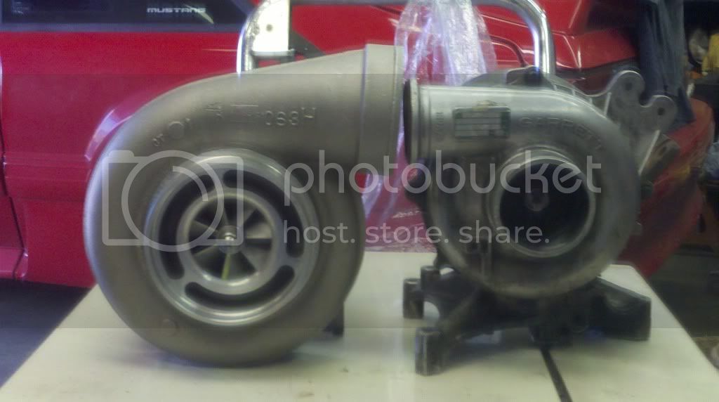

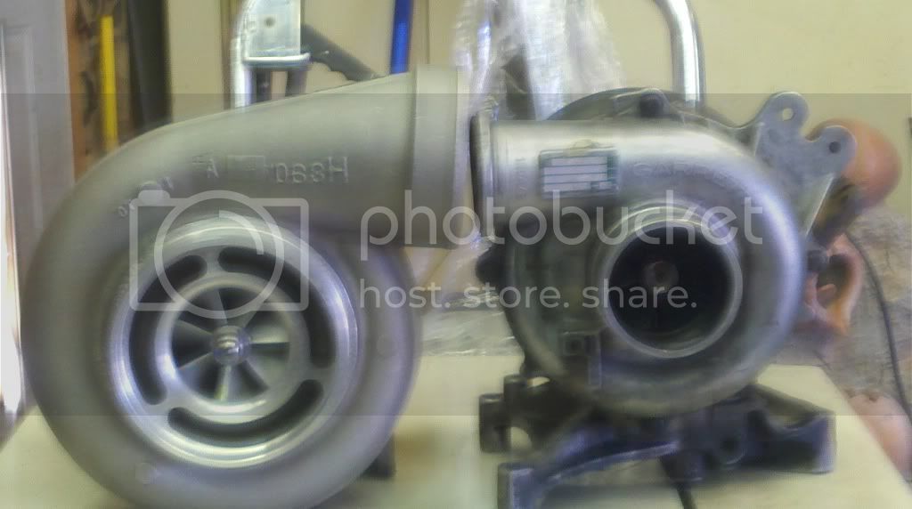

What turbo is that? Do you have any specs on it? You can pm me the info if you, I might be interested if its for sale

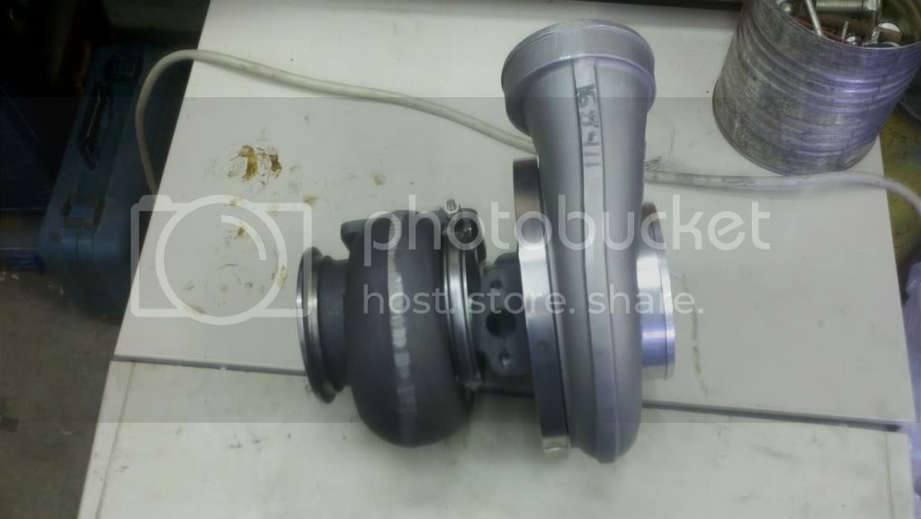

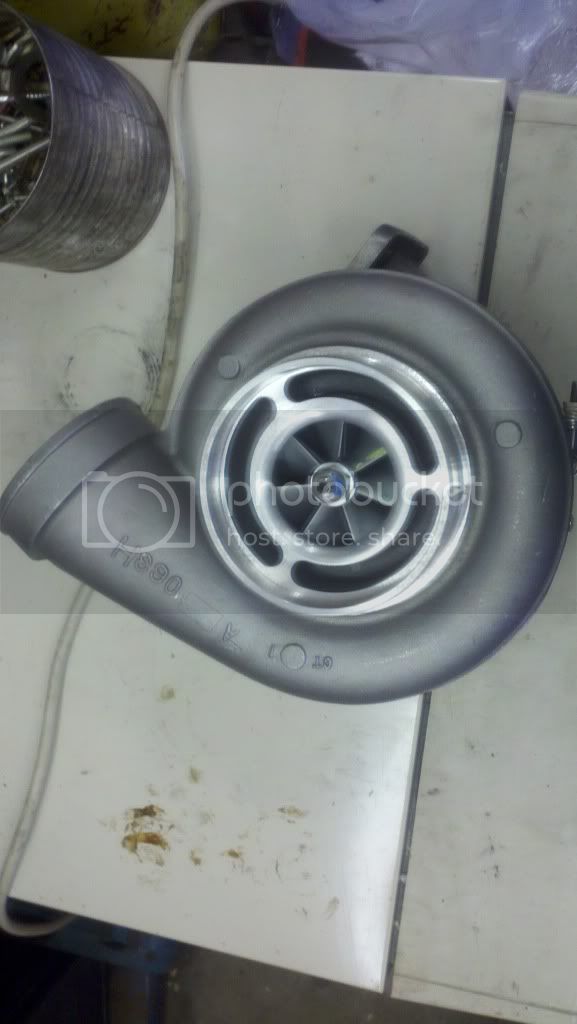

its a custom built turbo its a 102 over a 92 i think or somthin close to that i know its a 102 mm compressor just cant remember exhaust but the thing is custom built for a work stock pull truck

12.649 @ 110 or 111 on spray best time on fuel 12.90s around 102 103 mph. thats with a bad 2nd to 3rd shift. truck makes 520 h.p. on fuel 655 h.p. on spray. With a d66 and a waste gate. a d66 is small for my setup but works well on the street.
