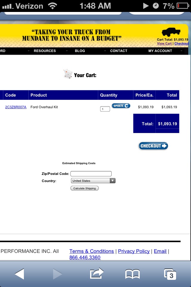

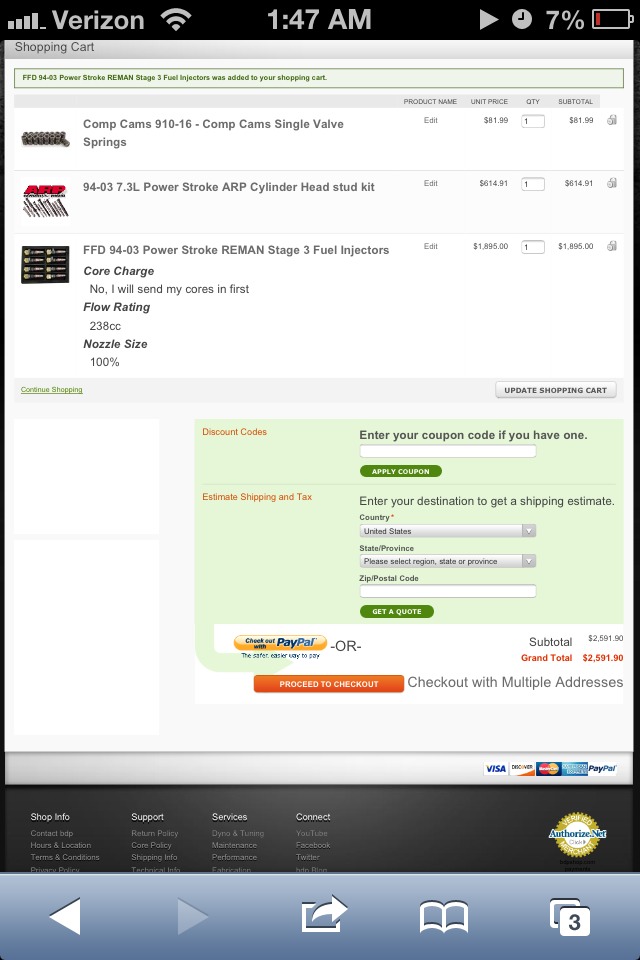

Lamont_24
Jun 12, 2012
745
Edwardsburg, MI
Does this look right? Am I missing anything? And I'm not buying it now, I'm just getting costs together right now. I added head studs because I'd like to do it while I have it out and just get it done with and that bill is without custom tunes. Let me know if I'm missing anything

lincolnlocker
27,913
176
Central Michigan
without a inter cooler stage 3 injectors are going to hot unless you get them detuned.. if your going to do that then you might as well get 250/200s and keep them detuned so that when you put a intercooler on it you can utilize them more... before you do anything get a compression test done... but yes those are the prices..
