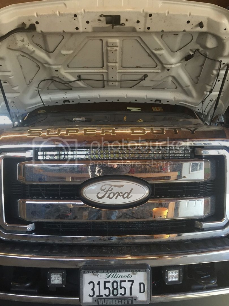

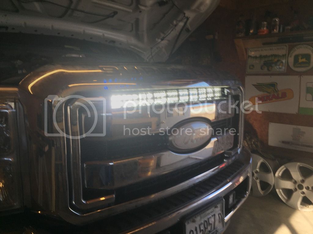

Put the bar I used on my tractor behind my grill. Had to make a couple brackets and cut a couple pieces of the grill out. It's a 31" curved bar. The pods in my bumper will be coming out and I used the harness for them to run the bar. Worked out pretty well.
Got some more pictures of that? As far as the curve following the grill, light output, etc. I've been looking at doing that on my truck
Yes I can get some more pictures tonight. (Still daylight here)
I had to grind some of the cooling fins off the back of the bar. It was hitting part of the radiator. I knew if the light wasn't on my truck it would be on the tractor and not concerned with the looks of the bar. It was pointed too far up last night when I was driving so I tilted it further down this morning. Waiting for this evening to see how it's pointing now.
Aug 2, 2011
934
Central Illinois

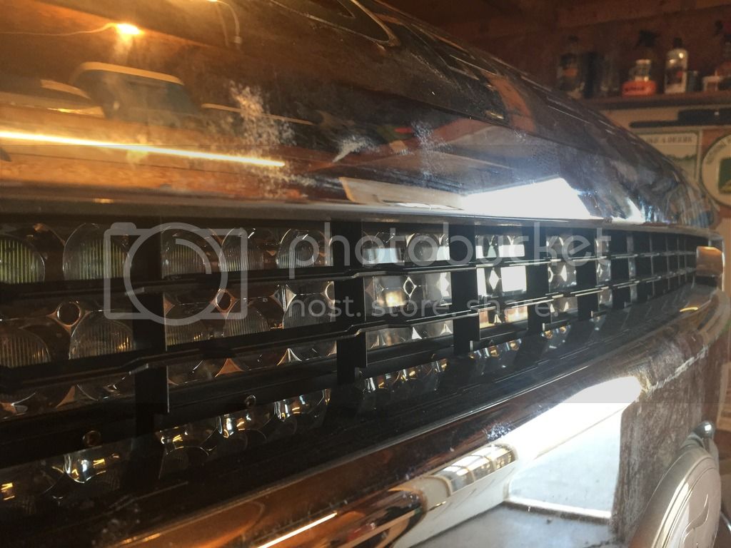

Here are a couple more pictures. Let me know if you need any other picture angle.
You can see it curves really well with the grill and you can see what I cut off the back of the bar. Looks like hammered sh!t but not worried about it behind the grill.
Picture of the backets I made. I drilled holes in the grill and ran some bolts up in there and snug them up and it was pretty solid. I had to cut some of the black plastic of the grill for the bar to sit a little more flush with the grill.
This is why I have to cut some of the bar up on the back. I was hitting this on the drivers side of the radiatior.
I'll try and get some night pictures of the light. I used it the two nighs ago and you basically don't need to run headlights it puts off a ton of light.
