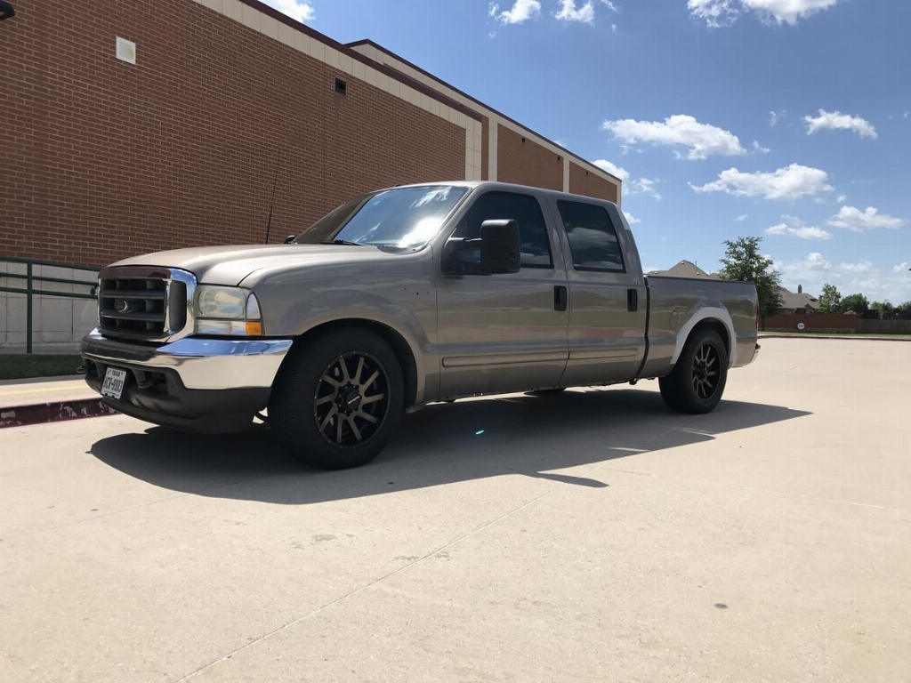

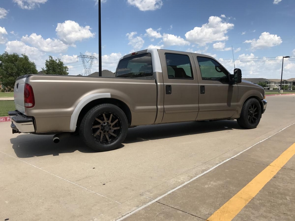

Put on the new shoes finally. Next task is to get it painted up!
2002 F250 2WD lowerd 3/4 (have another hole to go in back, might use it)
Raceline 932DM Twist Dark Tint 20x9 with +12 offset, no rubbing, can go full lock and not hit the radius arm.
Toyo Proxes STII 275/55R20 front and 305/50R20 Rear

that looks good ross! why the difference in tires? why not run all the same size?
I thought 305/50R20s would rub the radius arm like a son of a gun. On the radius arm I can't fit my pinkie between the tire and the arm. I might only have a couple pieces of paper worth of clearance but it doesn't touch!
I was also worried about goosing the fender over the ****ty frontage roads here in N Texas. The stock tires would go up inside the fender and hit the liner and I thought 305s wouldn't clear the lip. The 275s fully tuck and can swing all the way up into the fender liner and miss the fender lip (confirmed on the Dallas North Tollway tonight 😂).
On the rear the 305s would definitely collide with the fender lip if I put a big load on so it seems that my suspicions were right on. Got the air bags to fix that, they'll be going on soon.

How do you like those ST2s?
So far so good! Just ran around town so haven't been on them over 60 mph yet. They make a little humming noise between 45-50 mph but otherwise they ride better than the hard as a rock LTX load range E tires I took off! I like these sizes because they actually exceed the weight ratings on the door sticker. Toyo does say you have to derate them 10% when using a P tire in place of an LT which drops the rear to 5800 lbs from the door sticker 6042 but everything's works out close enough for what I use the truck for.
I'm thrilled with the look. I waffled back and forth between a 0 or +12 offset wheels and +12 is 100% the way to go for me. I was worried about clearanpce on the front but it couldn't have worked out more perfectly. I can't stand it when tires stick out I don't care how small it is. Shove them bitches up in there!!

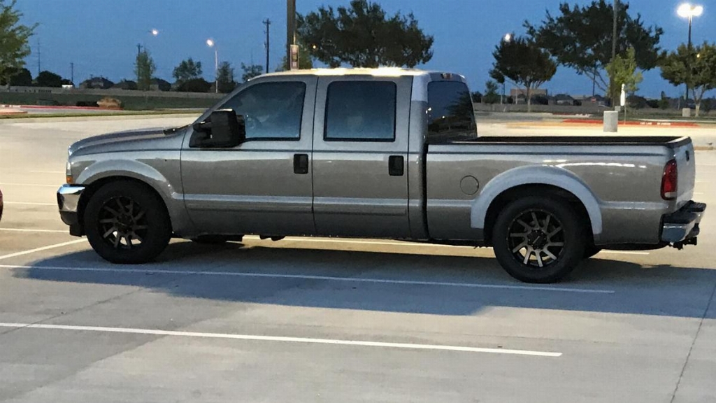

Took this pic running errands with the family tonight and thought it was pretty bitchin'
Sweet, I'm going with 305 50 20 like your rear tires all the way around. The weight rating is enough IMO.

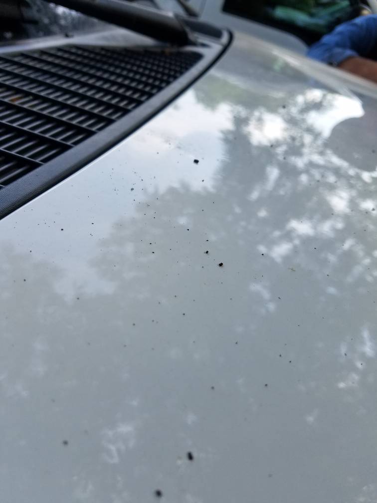

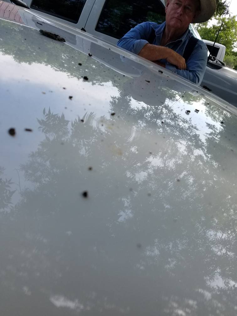

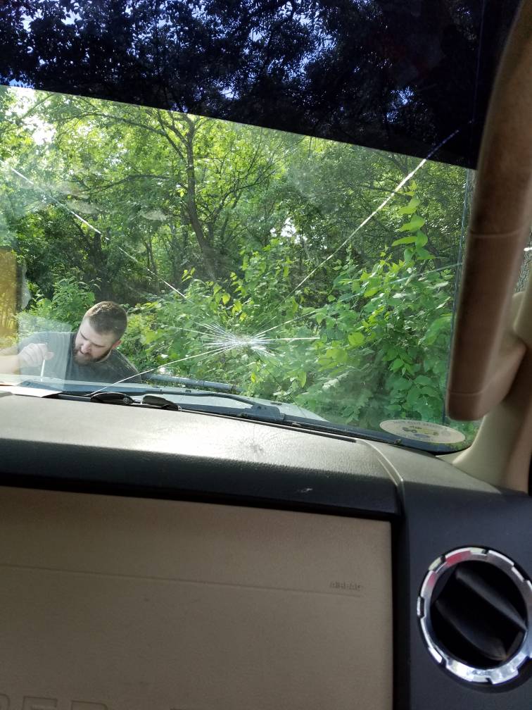

Friggin pecan tree limb fell on it...
Sent from my SAMSUNG-SM-G891A using Tapatalk
on the bright side you can use thst pecan limb for grilling a good steak. so yummy..

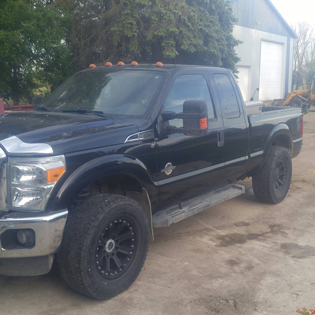

Got my new too me 20x10 pro-comps with 325/60r20 hankook dynapro ats on along with giving it a good wash and a quick buff.
for 325s, that looks good and not sticking way out with a big offset..
