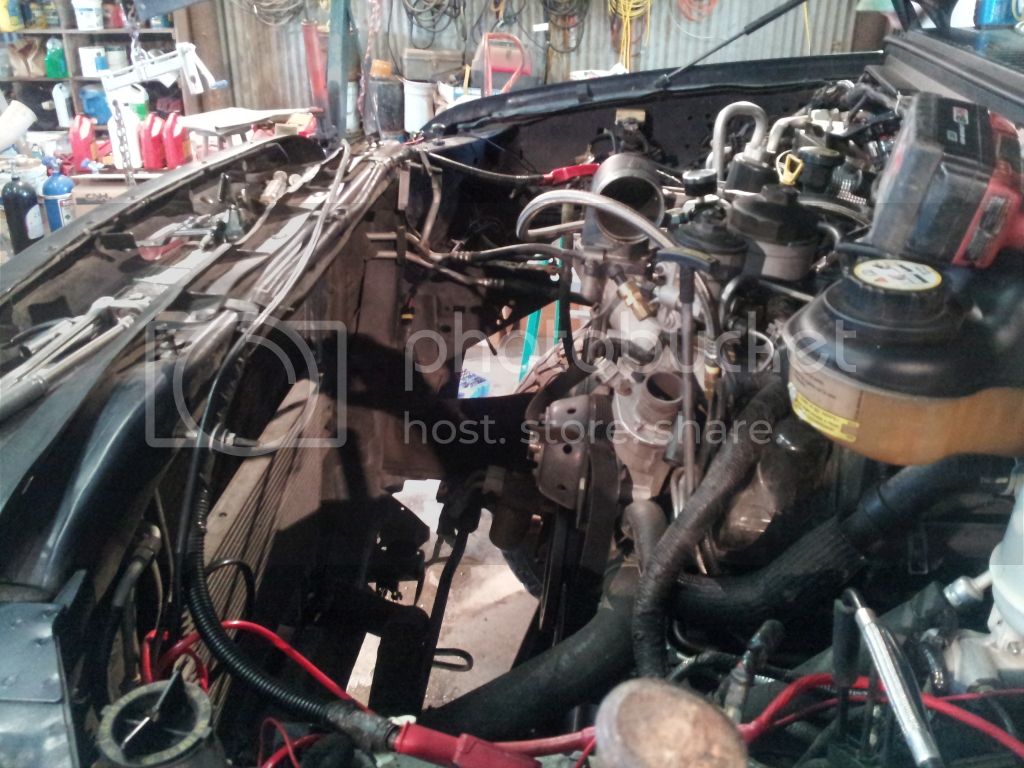

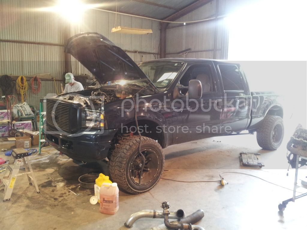

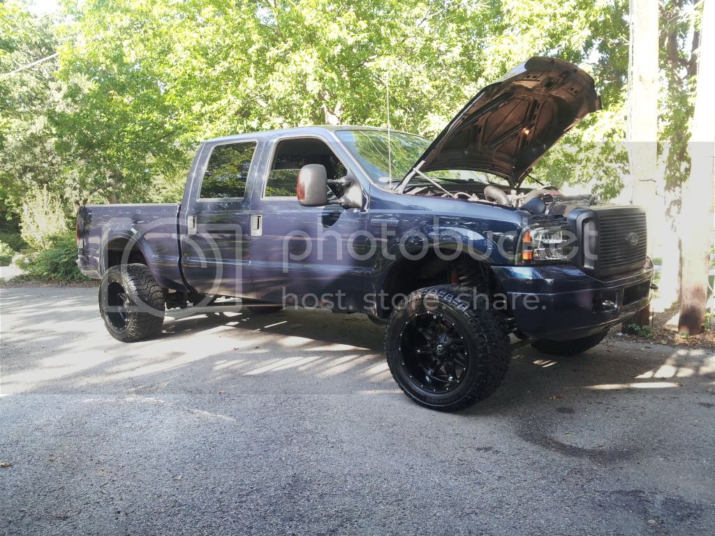

Ok...time for the big update. Compounds are in and running. Drove up to Cutting Edge Diesel at the Kubik ranch in Newkirk, OK. Several thousand acres of some of the most beautiful Oklahoma land I've seen.

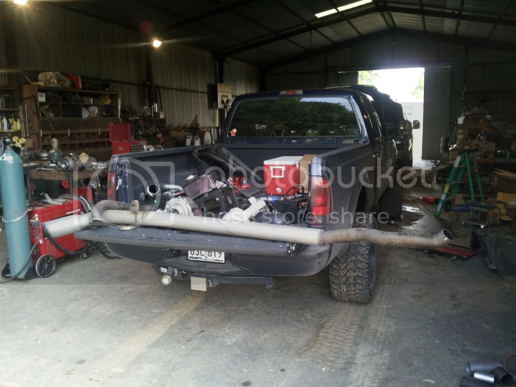

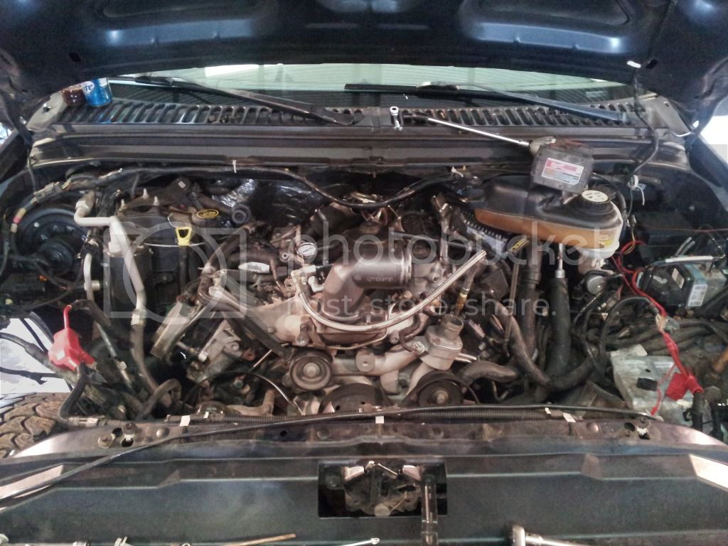

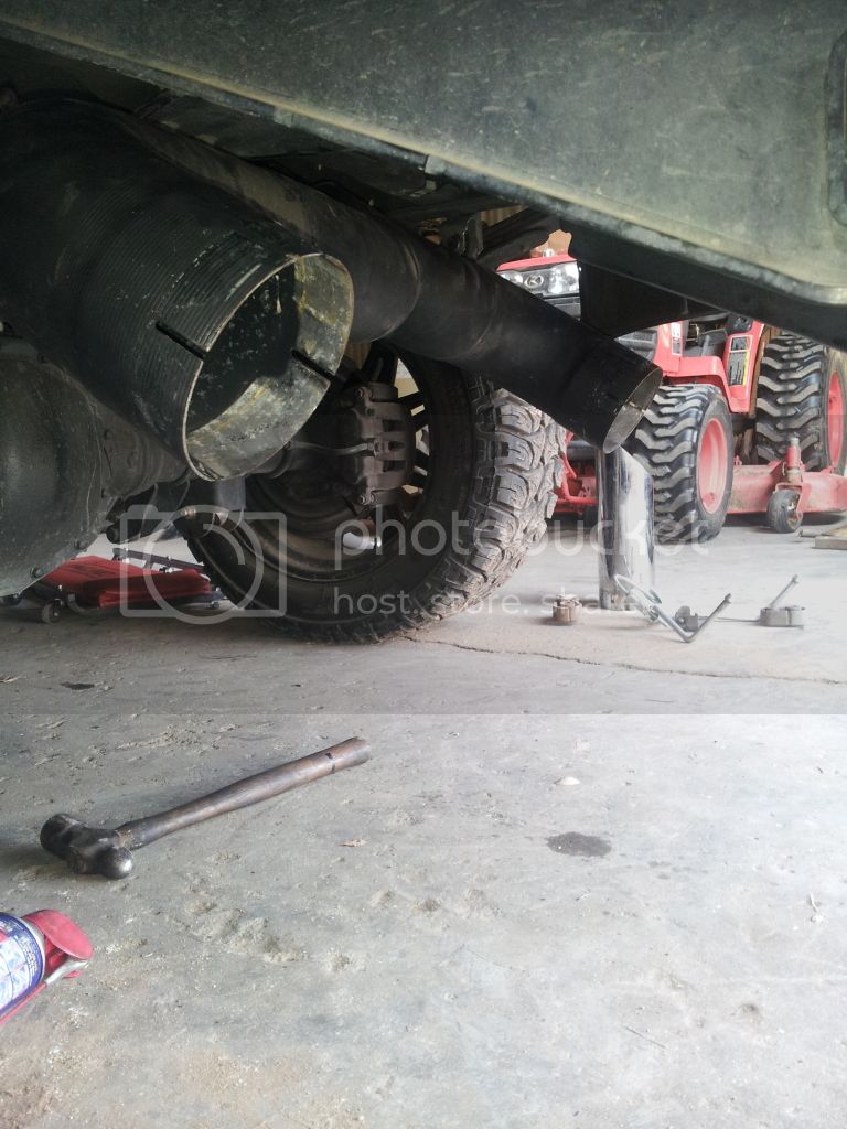

Anyways...as soon as I got there, we pulled into the shop and started tear down. By the end of the evening, we had all the old stuff out. Got the 68 pmax boxed up and sent to Kyle (kbryant777).

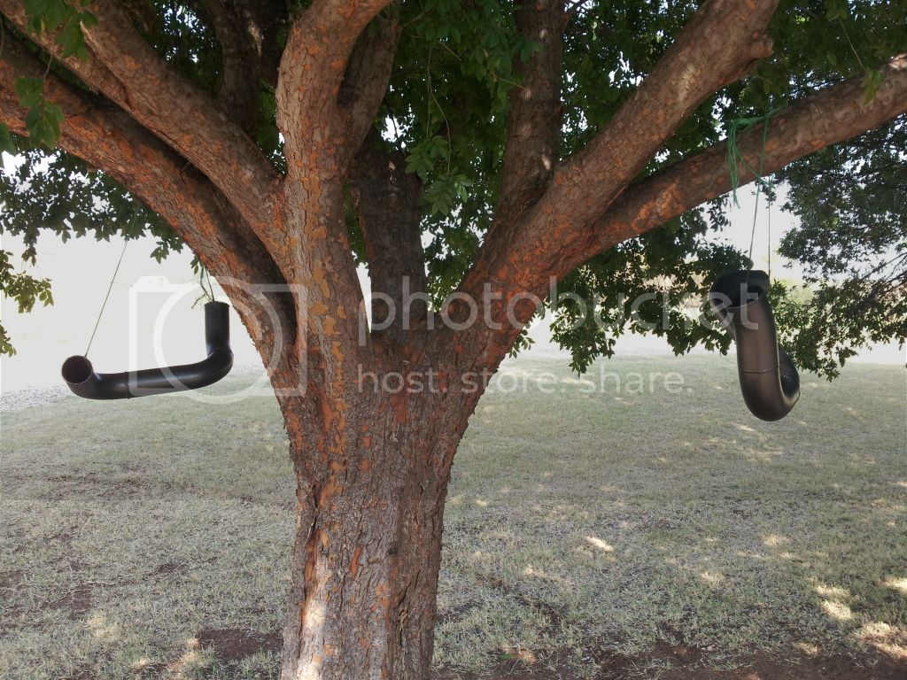

notice the bad ass exhaust complete with stock downpipe (fail)

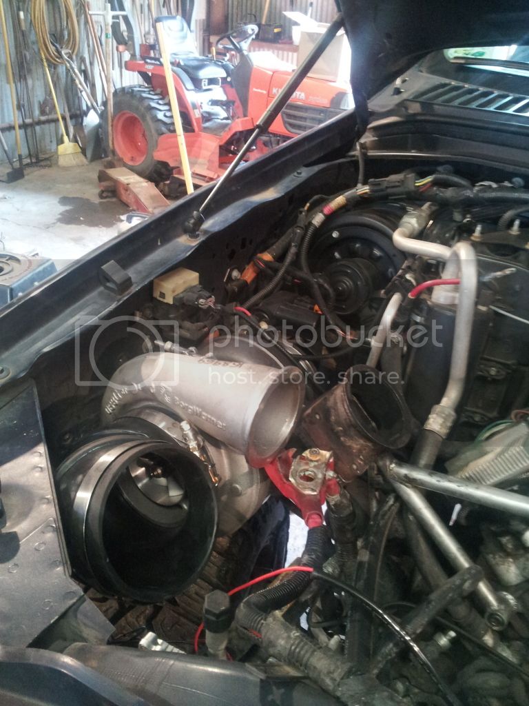

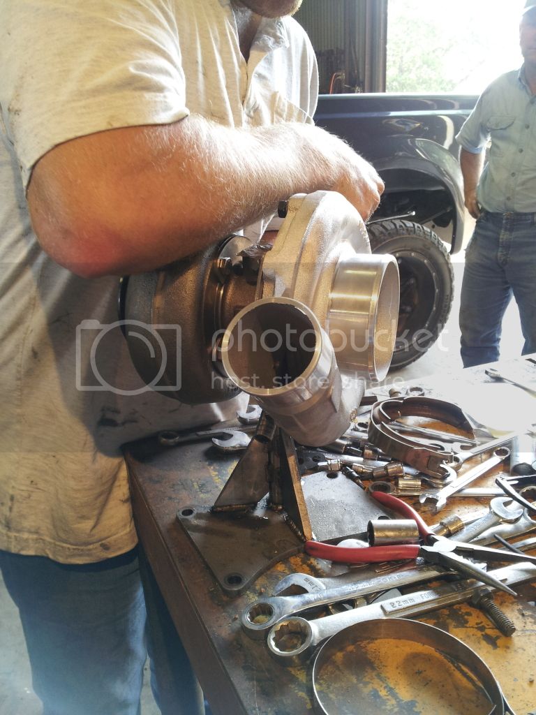

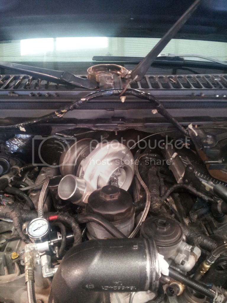

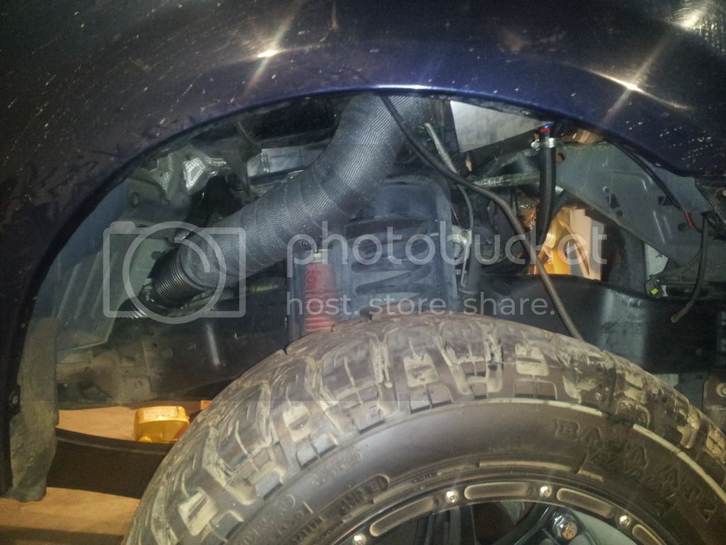

Day 2 and 3.5 were all fab work and turbo install. We had some kinks to work out with the wastegate not lining up so we had to screw with that for a few hours. while matt was working on stuff, i hit up the CED paint booth to spray the pipes.

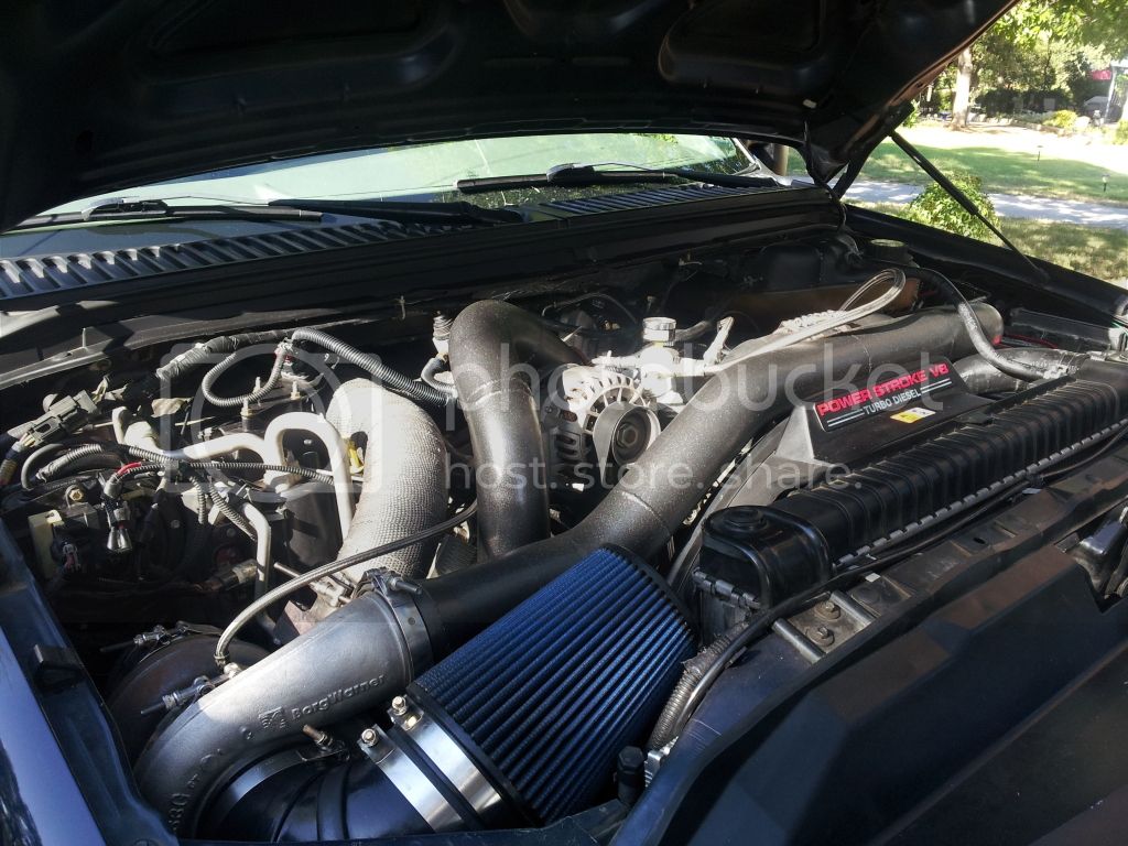

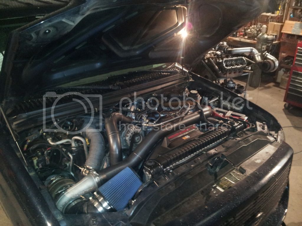

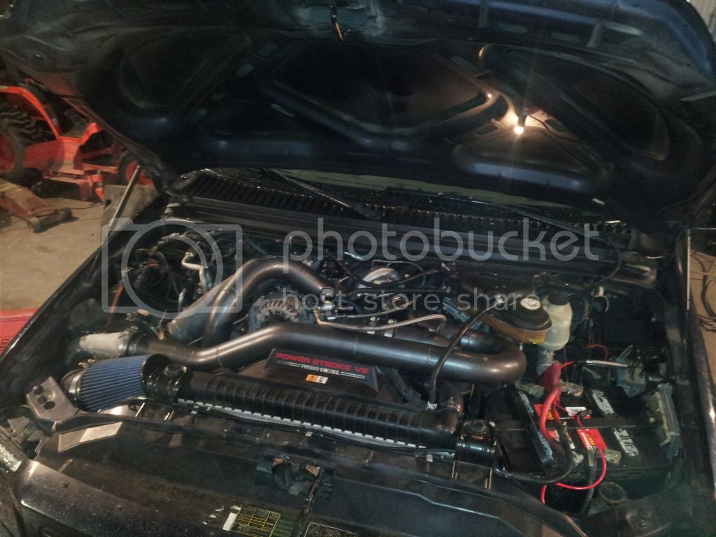

Finally got to finalize the turbo stuff and started stuffing them in along with the mishimoto intercooler.

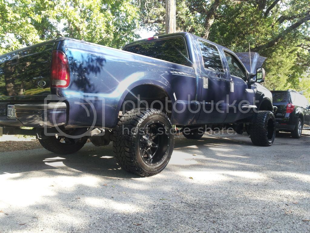

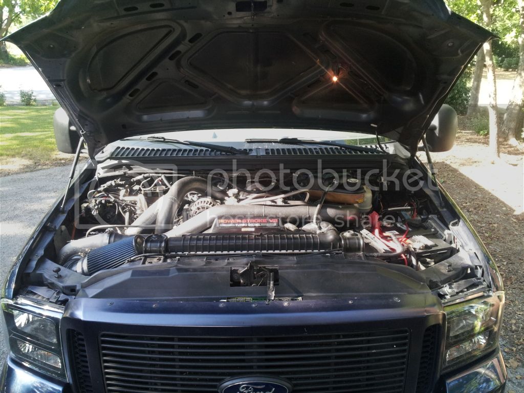

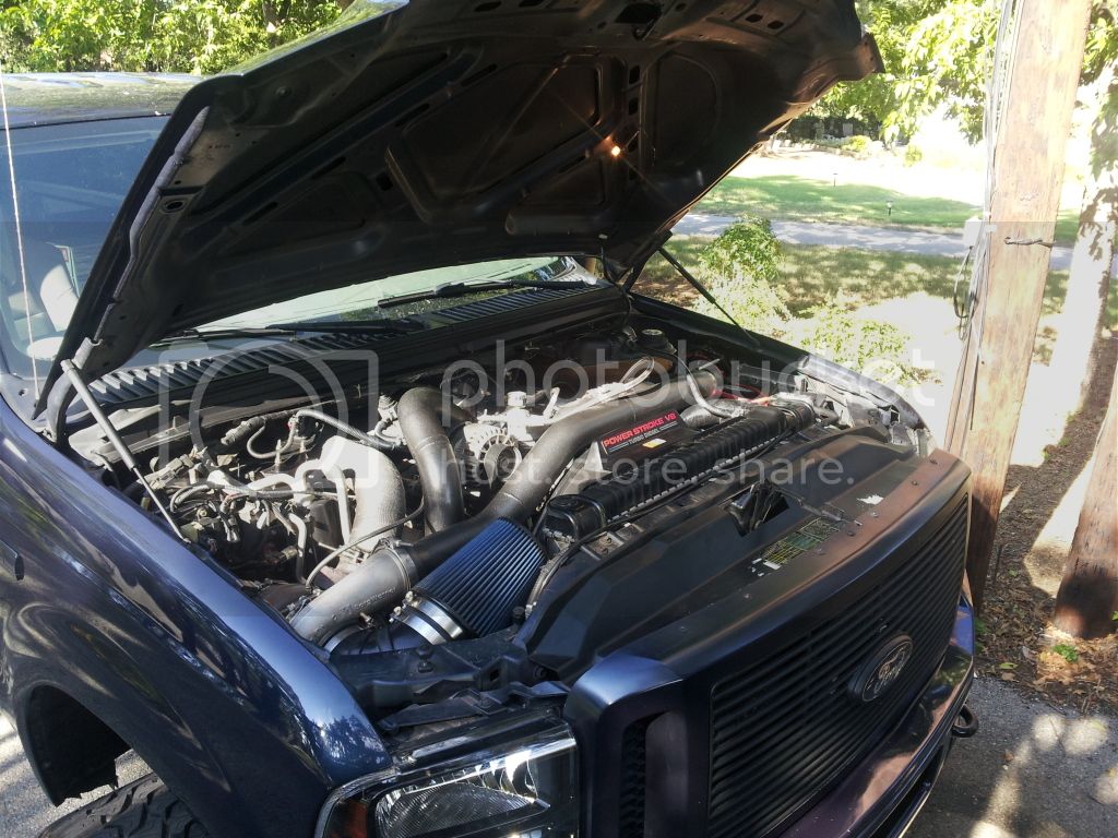

Saturday was final assembly. got it all together and made a few short trips (along with the burnout fail posted earlier.) No big issues at all. A few little leaks here and there but nothing I can't fix easily.
Got up early today and made a 5.5 hr drive home. No problems at all. Cruised at about 75 mph. Between 4-6 lbs of boost and 800 degrees. Got up to about 950 on hills. When I got home I finally got to get the truck all cleaned up. this week at the ranch was the dirtiest this thing has ever been but I guess that's to be expected when you're 11 miles from the nearest paved road lol.

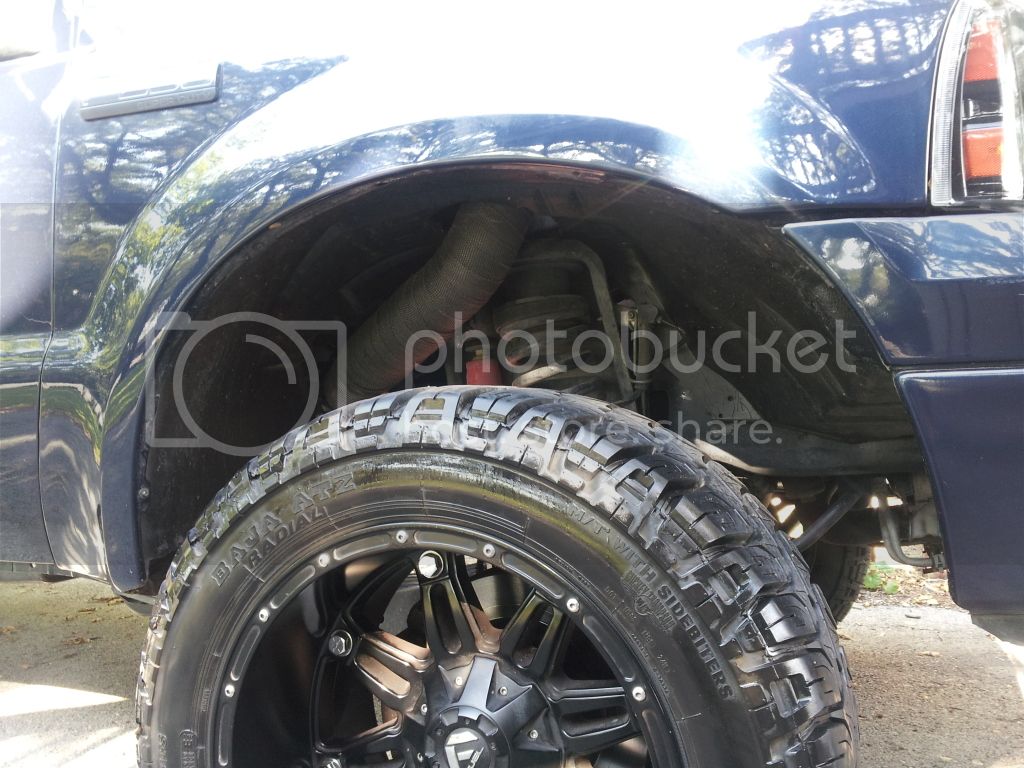

Looks sweet! Nice job on the install. I'd love to have that setup someday. Where does the atmo charger oil drain drain to?

They look awesome!

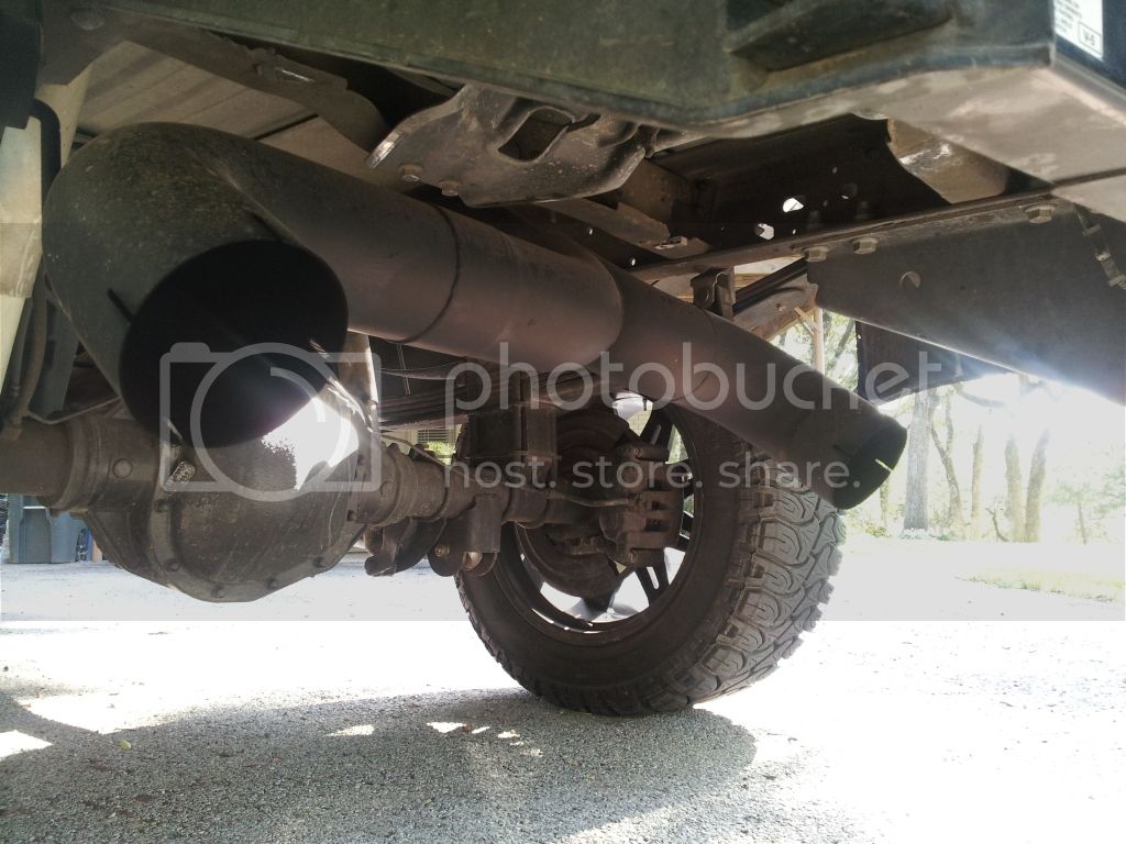

I'm a fan of the exhaust.
thanks! i actually robbed those off Deranged LOL. Still gotta get some tips for it. I'm thinking black or black chrome rolled tip straight cut.
