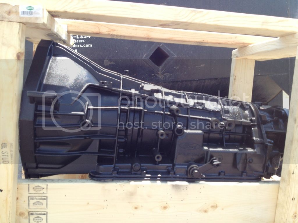

new trans all nice and shiney. Matt is going to be shoulder deep in cow pu$$y for the next month but hopefully we'll get it in soon!
BlueWaffle
3,239
Grapevine, TX
What type of hp are you expecting if you were to guess? Do you think you would have any trouble towing with it?
I would hope somewhere between 640 and 700. not too sure on the towing... my pyro gauge can move pretty fast. I think the ideal setup for towing would have smaller turbos, something like it 62 over a s475.
