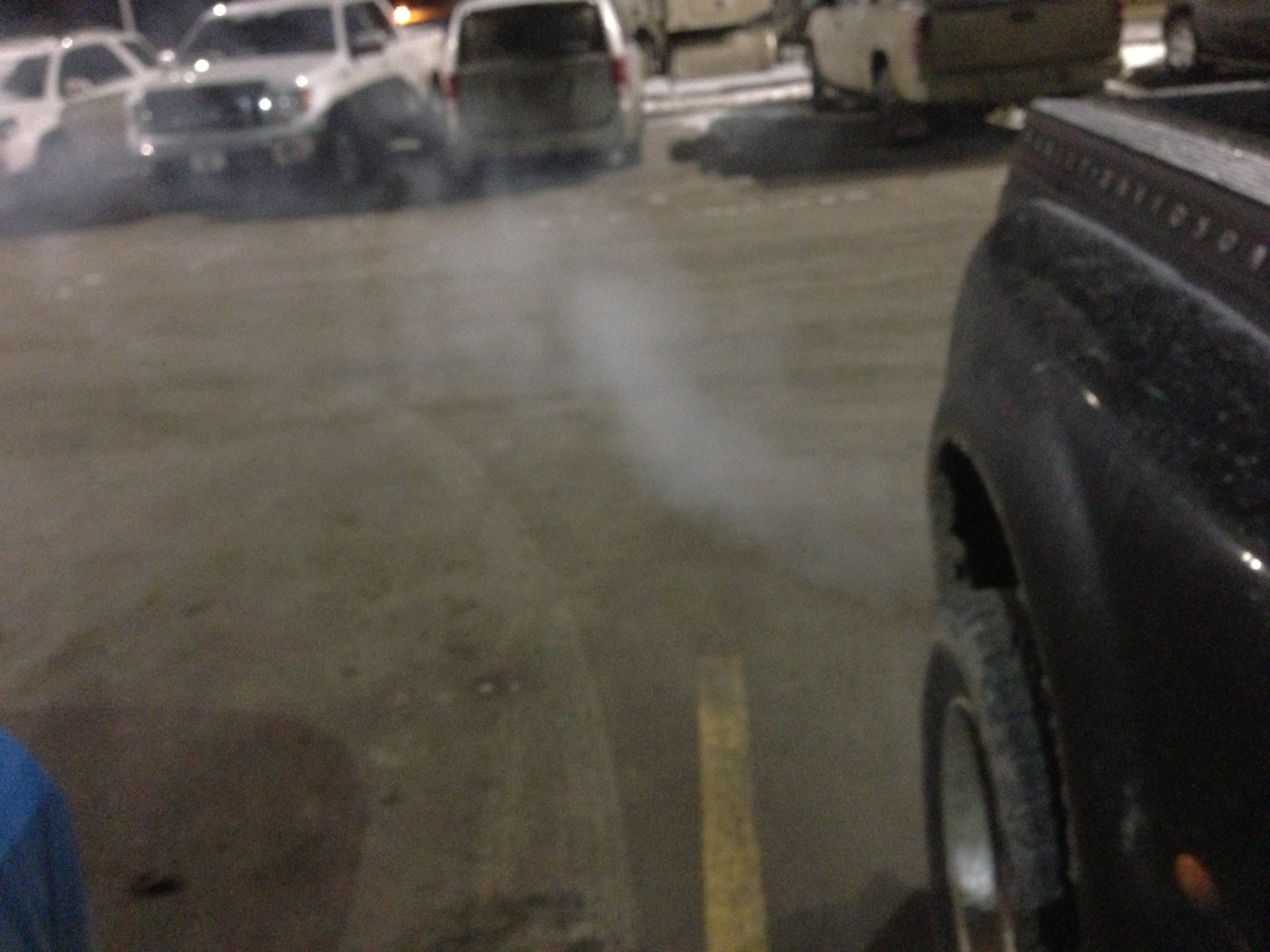

Proof that they will smoke. -16c plugged in over night. Should be colder tomorrow night. Below -20c. I won't plug it in and will get pics. As much as I hate to cold start my truck at those temps I will for the team and to put this to rest once and for all LOL

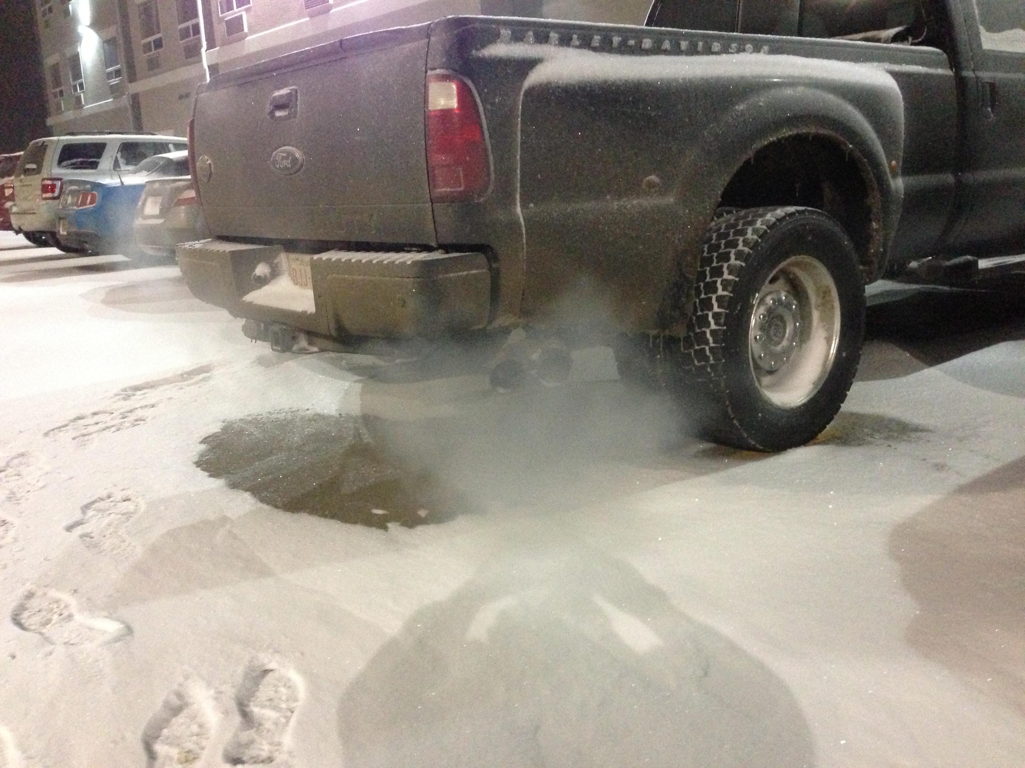

And finally not plugged in. Only got Down to -8c (20f) last night and thevsmoke is much more evident. Pictures taken before truck idled up. I was much worse after that.
