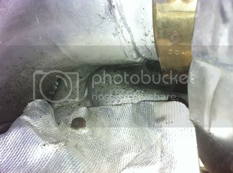

Drove my truck back from Houston after getting studded, and on my way home it kept blowing a boot.. every time I stopped to tighten it, drops of water sipped out.. wonder if mayb my intercooler still has some moisture inside. Blows a puff of smoke when I turn it. Doesn't smell like oil or fuel.

If you have a valve seal problem you will smell oil burning and it should go away within seconds.
That picture to me looked like soot mixed with condensation that found it's way out the clamp.
You might want to take a video but I don't think you need to be worried yet.

I know mikes did that and the end result was pushed out seals
i think i have damaged a ***king motor in every way possible at this point. that being said, smell tells the tale, period, although damn that does sure look like oil smoke. one time when i had turbo seal back pressure issues it would do that every time and i had oil in the down pipe. easy to see .
