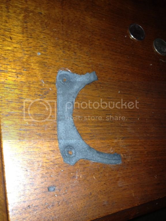

Drove it again, couldn't help it. Looked over the motor before I went back inside and found this...the remnants were next to the oil fill bowl lol. Guess that didnt help boost.
CFM elbow I presume? Ditch that thing, I had the same issue with mine, stupid paper gasket always blowing out. I had to carry spares with me for roadside change outs till I scrapped it.
