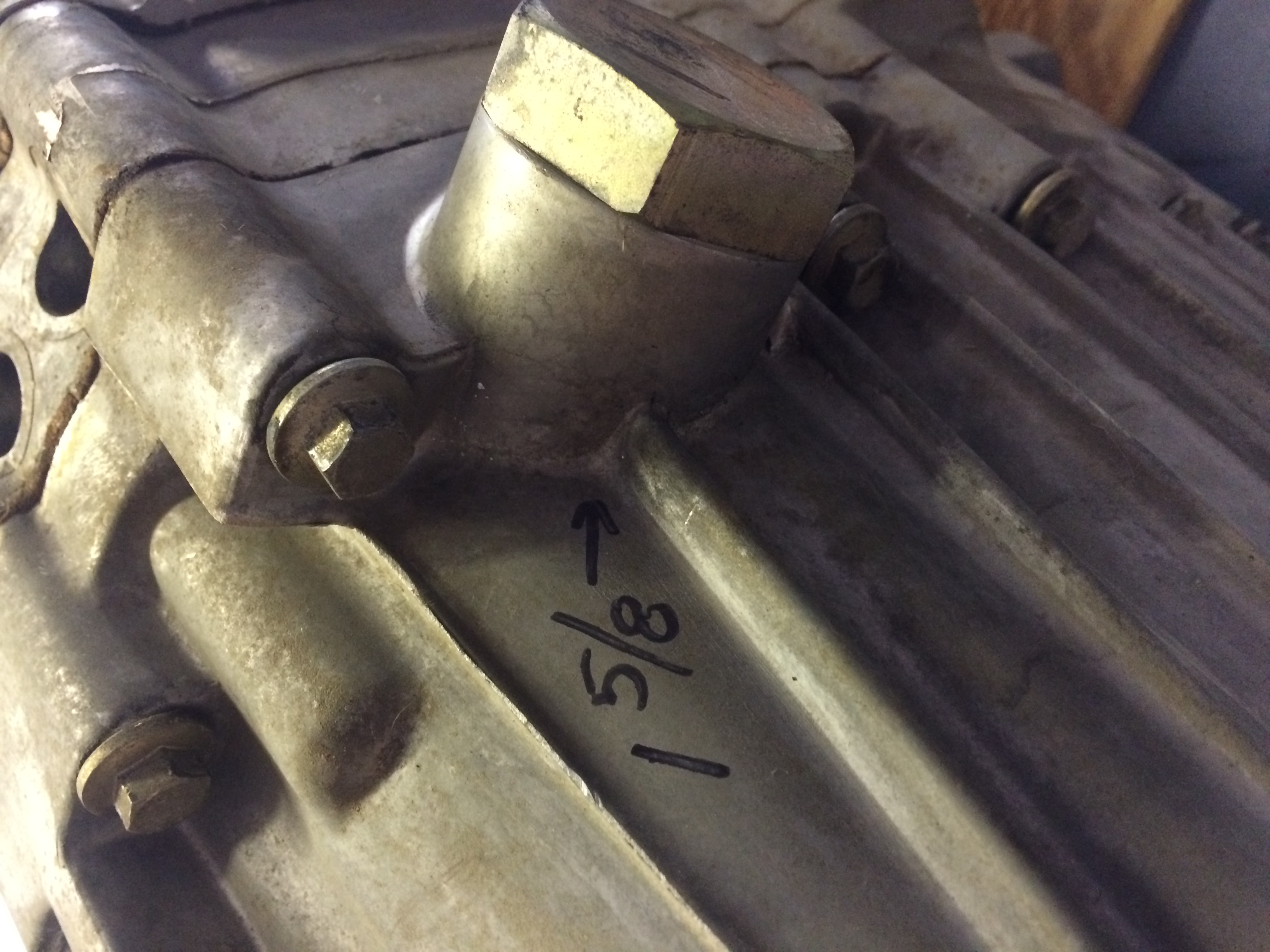

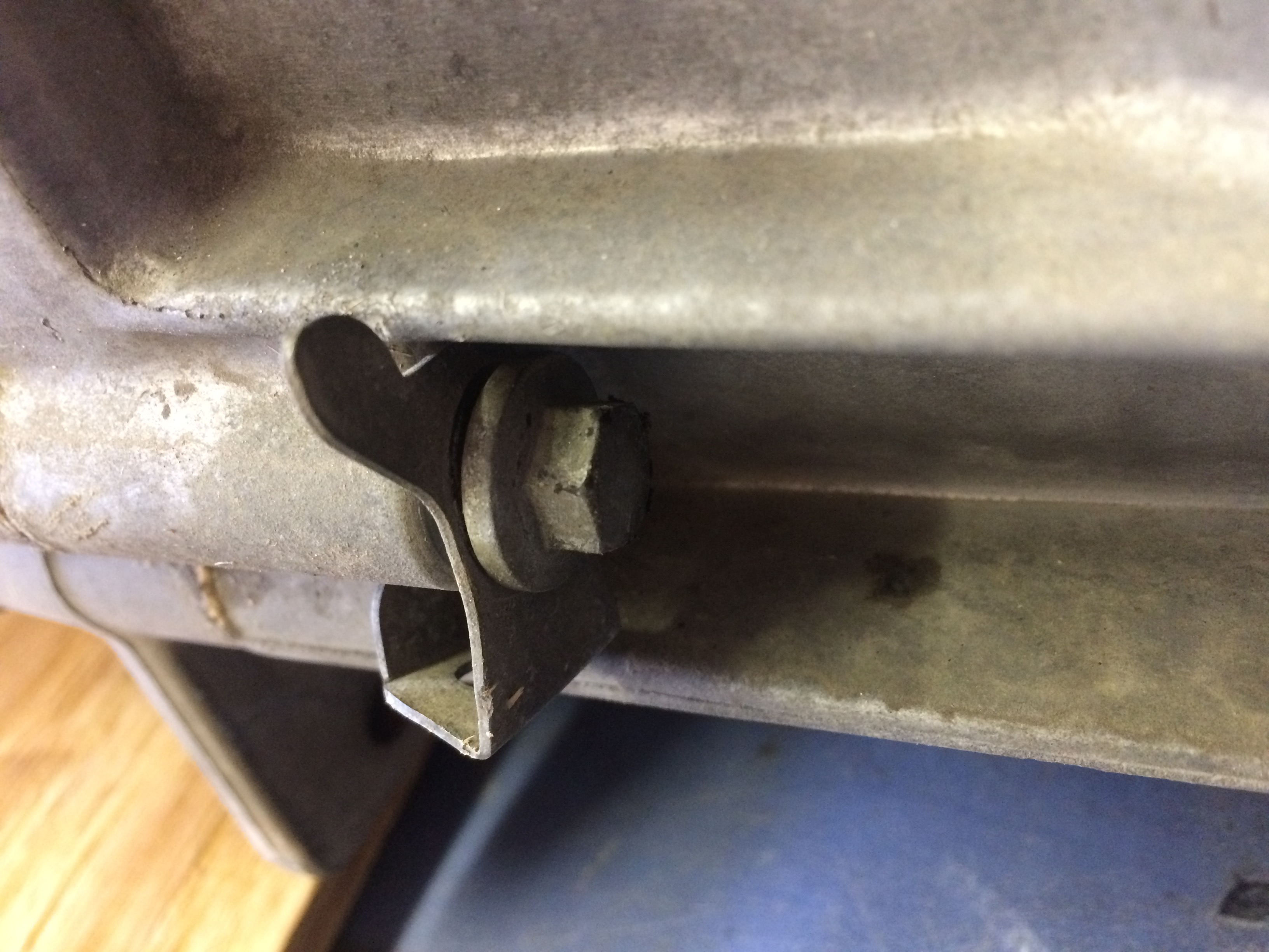

ZF6- Rear Case Images
See attached for images during my tear down process

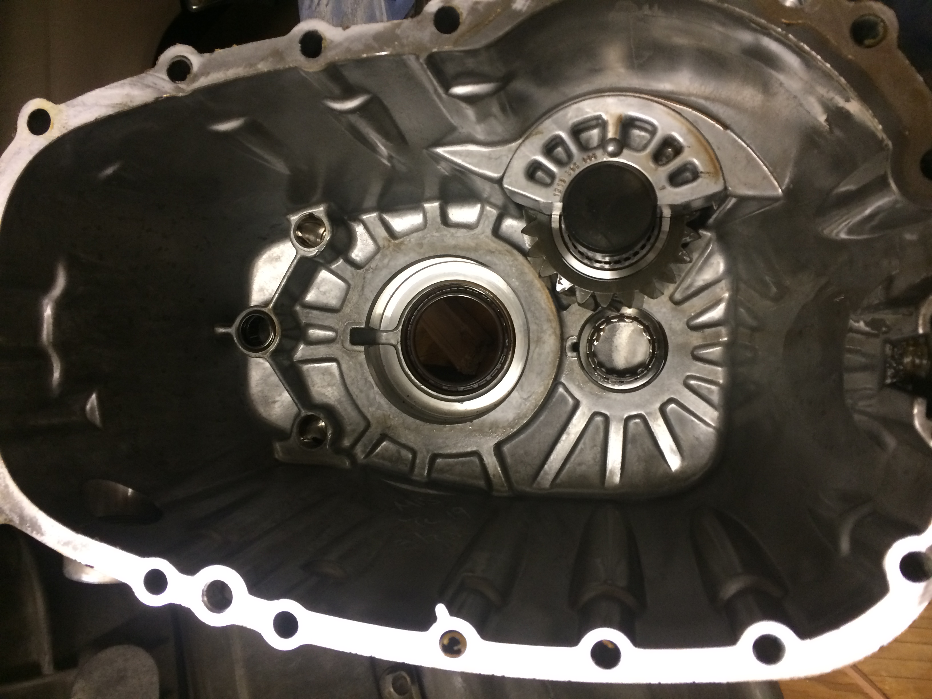

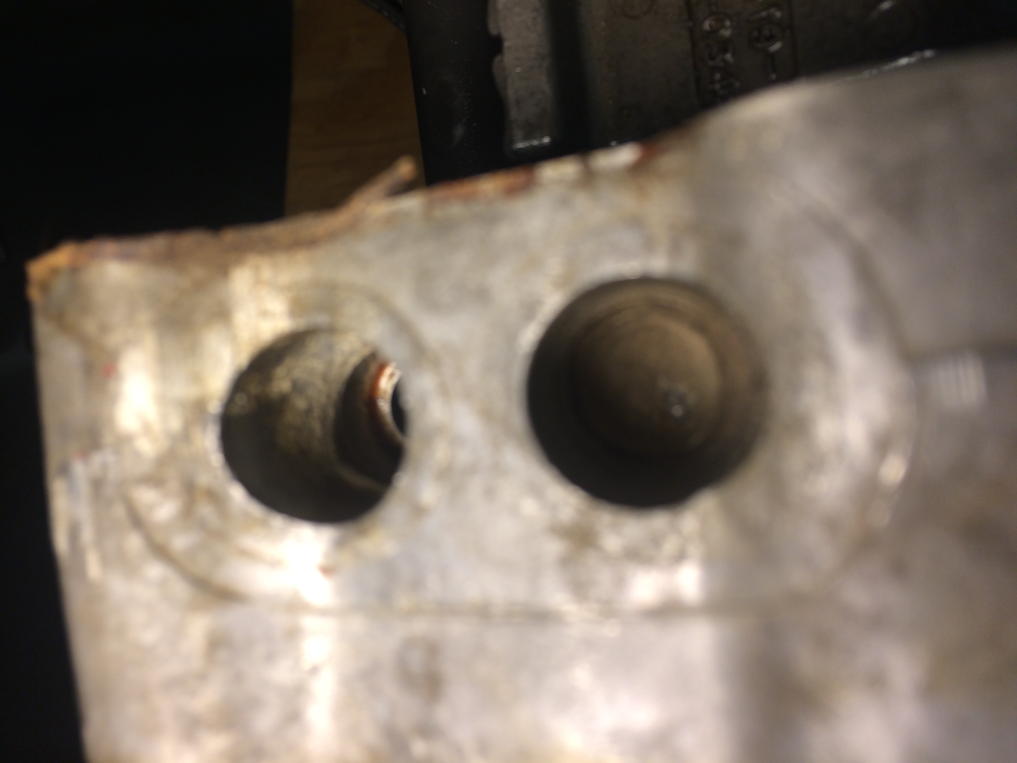

ZF6 Intermediate Housing tear-down pics
Intermediate housing tear-down
Note*** My Early 99 had three Allen bolts securing the Intermediate housing to the Main case. Later models (and replacement main cases) have 2.
Take note of the electrolysis (corrosion) on the Allen bolt threads. They are steel against aluminum. Someone on the last rebuild didn't properly coat them with Never-Seize. This phenomena is why homes back in the 70's that used aluminum wiring burned down from heat generated on the contacts of aluminum wire to copper breaker switches. Dissimilar metals (molecular structures) always try to balance themselves of free electrons, producing the natural end result, a sulfate (base metal salt).
Note to self- make sure you bathe them in Never-Seize.

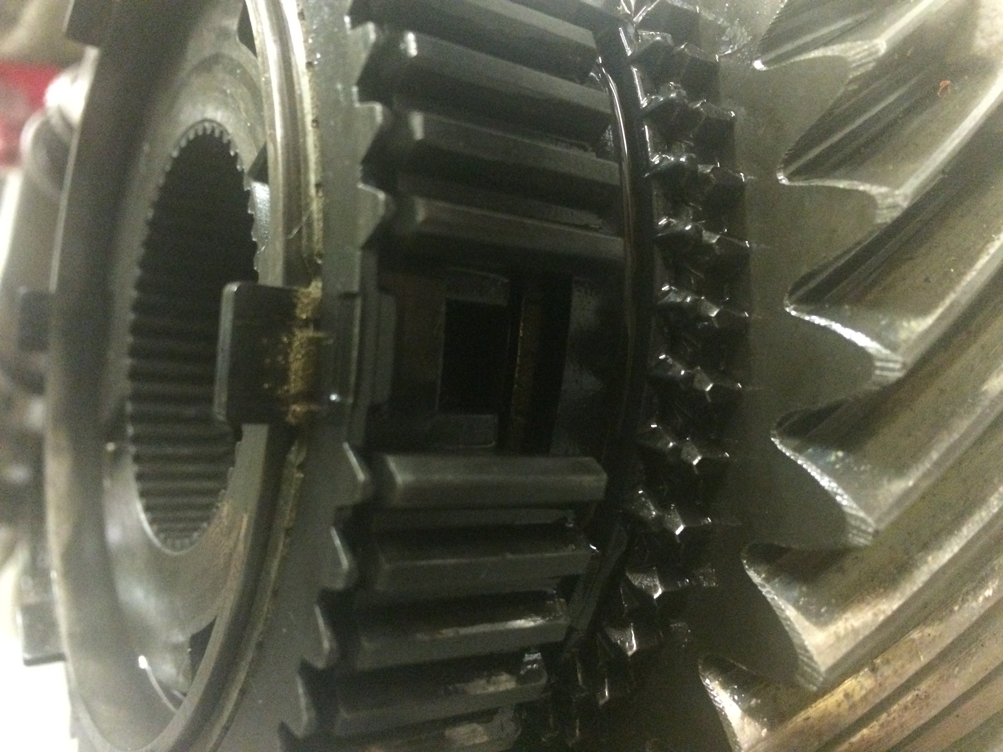

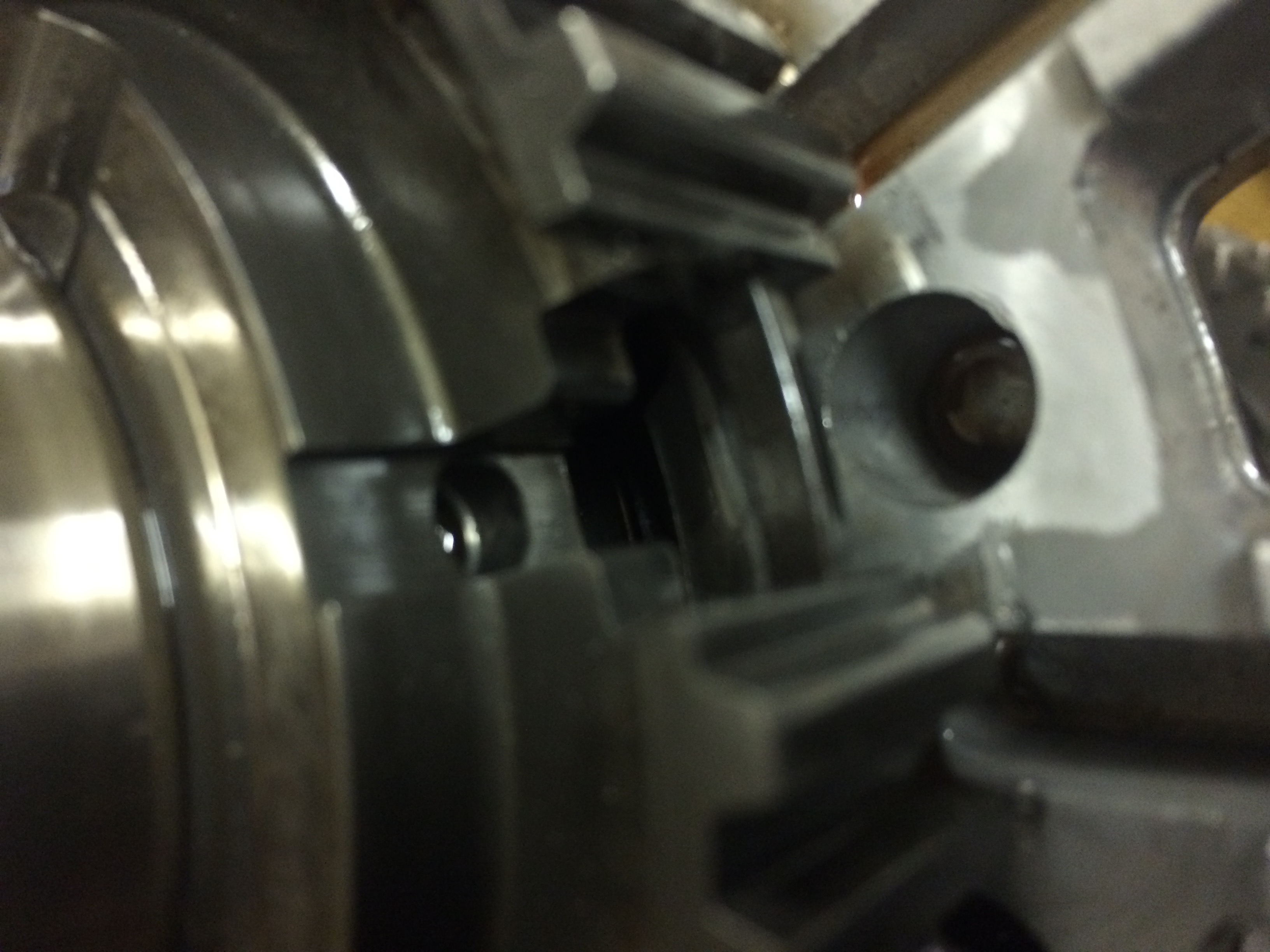

ZF6 Mainshaft and Countershaft disassembly pics

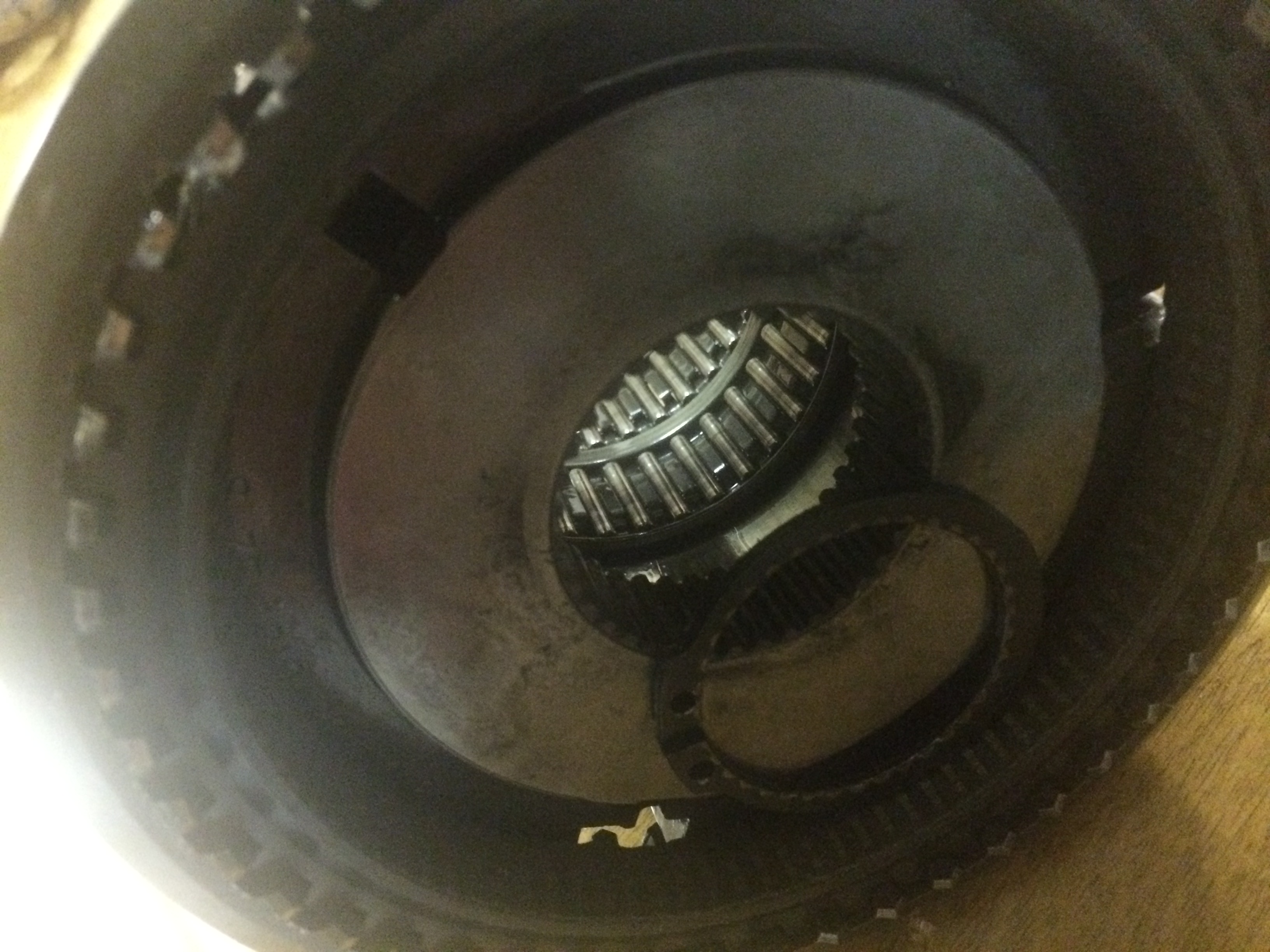

ZF6 Mainshaft and Countershaft disassembly pics (more)
