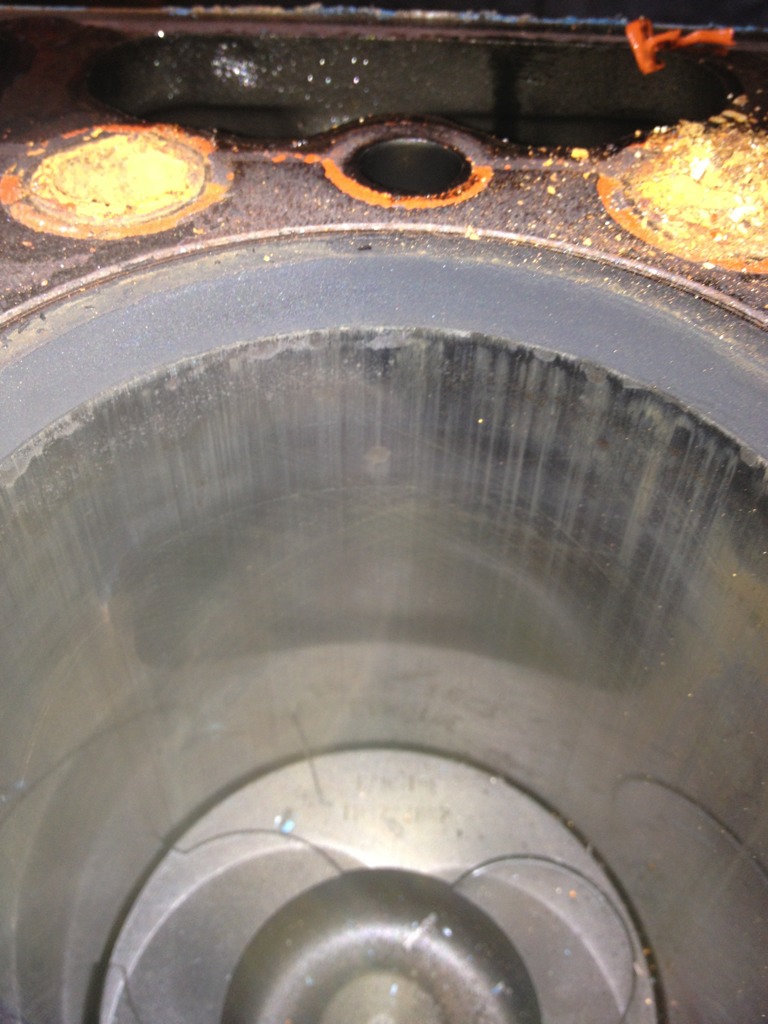

Well, the head is off right now as the valve guides have to be machined to fit the new springs, and she looks pretty good inside. Gonna have the head ported and a valve job too since its off. Go big or go home!

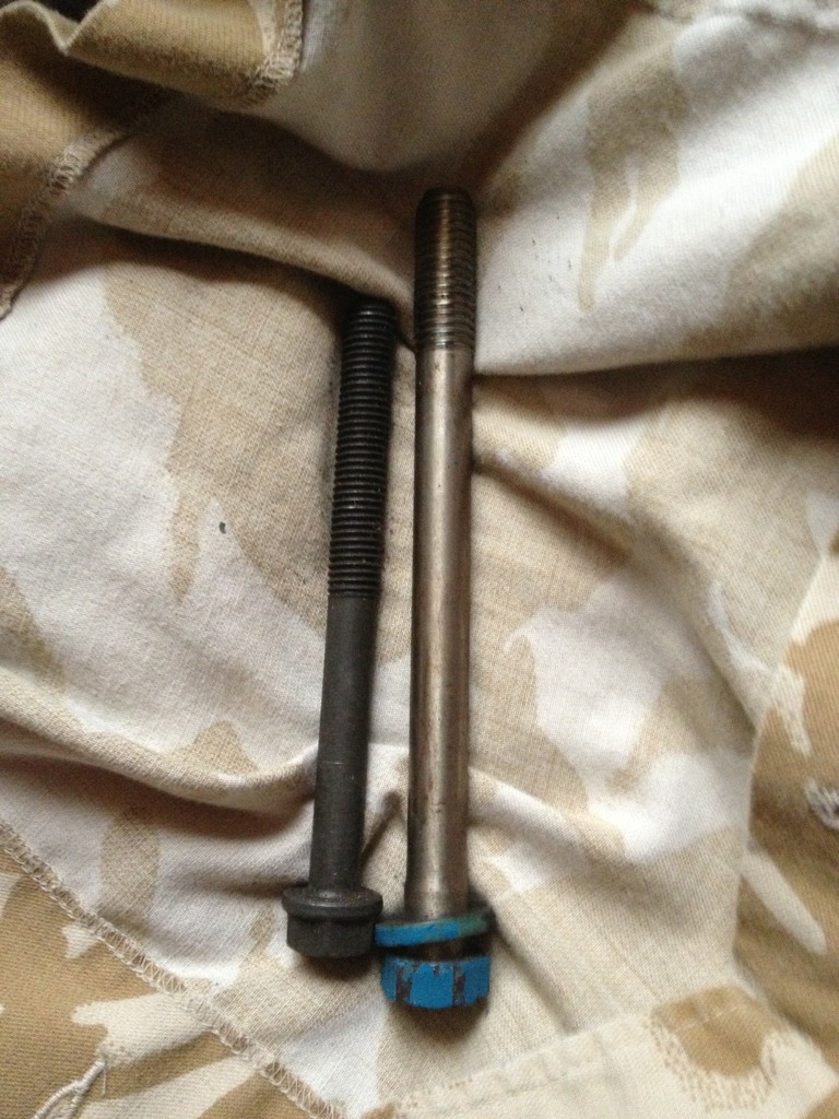

IH head bolts vs cummins 5.9 head bolts...
